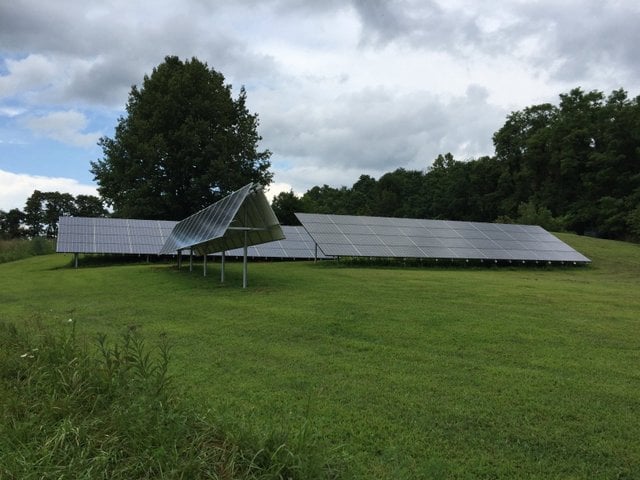

    Looks like you have plenty of room for a ground mount that faces south.

  • manzanita2

    Food Dish Cuisine Pizza Pepperoni Ventricina Meat Ingredient Italian food Salt-cured meat
    Don't toss your pizza loaded. Don't solar people know this?
    Or was it a delivery?
    Off Grid. Two systems: 1) 2925w panels, OB VFXR3648, FM80, FNDC, Victron BMV-712, Mate3s, 240 xformer, four SimpliPHI 3.8; 2) 780w, Morningstar 30a, Grundfos switch, controller and AC/DC pump, 8 T105. Honda EU7000is w/AGS. Champion 3100. HF 4550, Miller Bobcat.
  • Miller_Ranch
    Miller_Ranch Registered Users Posts: 53 ✭✭
    Mike will take care of your roof mount problems.Article Lead Image
