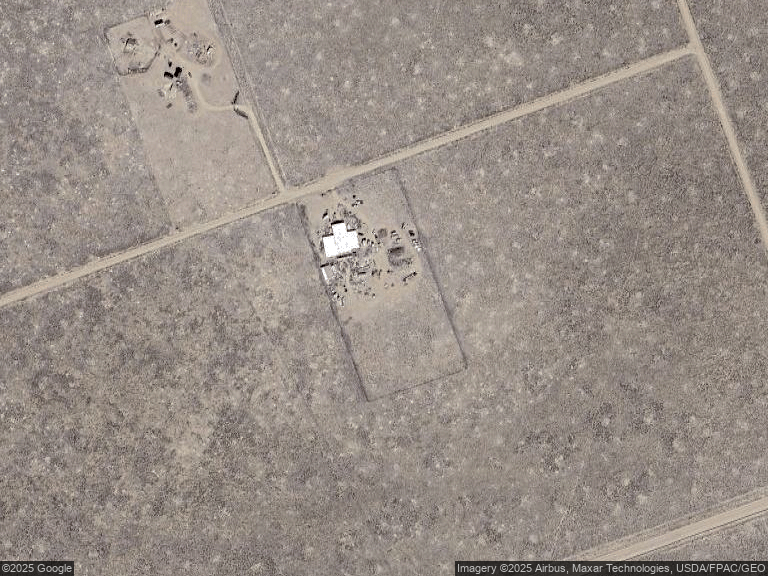

Panels follow roof contours. House is not exactly south facing. Pretty close.
Southern array performs great except for summer months. Panels at 42 degrees to maximize winter production.
East and west panels at 10 degrees. Racks were included with main south facing racks. Free.
The west panels are simply 180 degrees from east panels.
I never get more than 8.5 amps from three 5.2 amp panels at high, sunny location. West Side disappointment.
37 degrees latitude.

    Looks like you have plenty of room for a ground mount that faces south.

    For several days I had not production from the westerly panels at all. Bad MC4 connection going to the wires going to the CC. Messed around with it and got power. But unsatisfactory power.
    Could a poor hand made MC4 connection be lowering production by about 50% or so?
