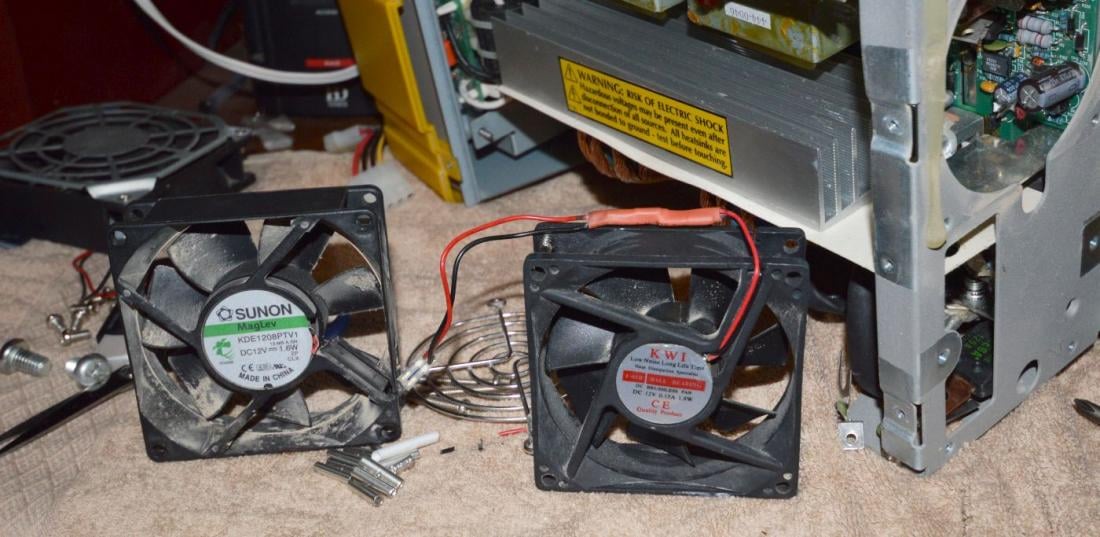

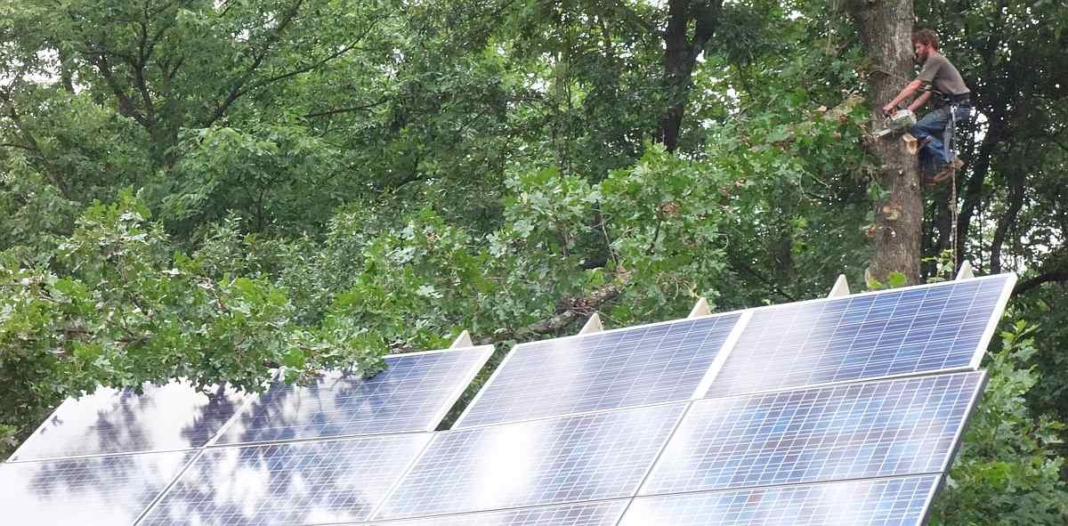

    Even with abuse, a tree trimmer dropped a limb on my array breaking 1 panel. Later a tree was blown up hill and got another. ALL the electronics are hanging in there nicely! While I replaced the inverter with one I had specifically originally the Magnum 4024, the old Prosine still works fine after I replaced the fan in it. It worked but would shut down above 4-500 watts.
    Replacing the fan wasn't too difficult.
    As it still lives outside I need to pull it apart and blow out the dust, and the fan I replaced is getting noisy.  It's working fine!

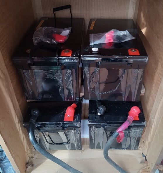

    This spring I replaced the 16.5 kWh forklift battery with about 15 kWhs of LiFePo4 batteries 4-280ah 12volt. I have found them amazingly efficient,  and they have worked out well so far. Spent today insulating the outdoor battery box for them...
    Amazing you can replace a 1000lb lead acid battery with about 300lbds of LiFePo4s. I used an crate from an engine shipped in and put 4" of insulating polystyrene top and bottom inside and a 1/2" on the inside walls, and another 2" all the way around and top outside. I've got an old 50 watt heating pad from before the auto 2 hour shut off on a thermostatically controlled outlet for heat tape that comes on at 50 degrees.

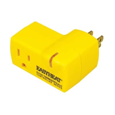

    Hey Whit,  does that easyheat also send temp data out to a smart phone?  I should check it out....
    No it's just a dumb bimetal strip thermostat. I think good for up to 400watts.
