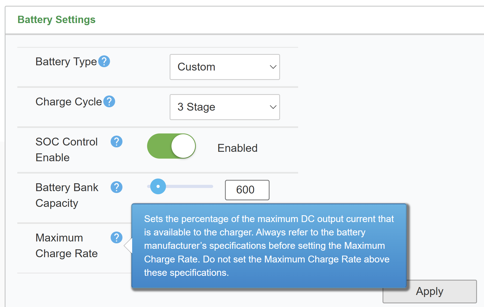

Is there any difference between just starting a generator and putting power in AC2 and starting a generator using: AGS Configuration, Generator ON, Apply?
The reason I ask is that I've had a few incidents where manual input of power to AC2 by just throwing the AC2 breaker on a running generator bogs the generator down on qualification by the XW, despite having set the XW Charge AC breaker to the correct initial value.
Never seem to have that problem via the AGS software start route.  Does the AGS route into XW charging have a softer start built in, or?
Even via the AGS method I run the startup process under supervision, gradually ramping up the AC breaker setting until the generator settles to each load increment.  Wish the AGS or XW software had a linear charging current ramp up function, but maybe I'm missing something....
