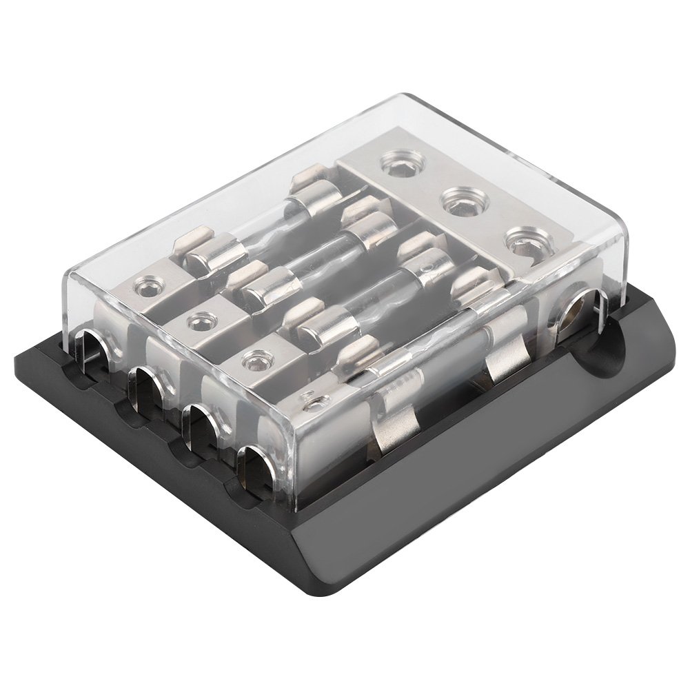

    You don't need a Midnite combiner box, but should have each string fused. You can likely source them locally.  I think you are in the Philippines?

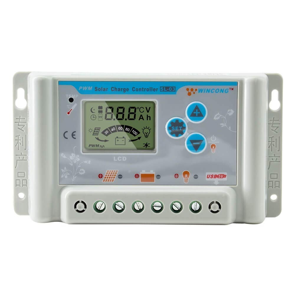

    Something like this 30 amp PWM Charge controller, can work with all 10 of your panels to charge your battery bank. The difference is IT WILL NOT CONVERT FROM THE HIGHER VOLTAGE! So the input voltage would have to be no more than a string of 2 of your panels.
    This charge controller will work with your 48 volt battery bank, I was helping a friend find a cheap PWM Charge Controller for his 4 - 24 volt nominal panels (you have 24 volt nominal panels, They can charge a 24 volt system with some loses or a 48 volt system in a string of 2 panels)
    https://www.amazon.com/PowMr-Controller-Compatible-Temperature-Compensation/dp/B07STYT56M/ref=sr_1_3

    We figured out it was made by Y-Solar who makes a lot of charge controllers which get rebranded.
    It doesn't have any of the features of the Midnite Classic, but might be small enough it would ship cheaply.
    To use this you would have to configure your array into, up to, 5 strings of 2 panels. Combine them with fuses or breakers. You could use 4 panels, 2 strings of 2 panels without fuses or breakers. My friend has 4 panels and uses a simple 'Y' connector to combine them;

    If you look around at auto parts place you are likely to fine 4 and maybe 5 way fuseblocks for AGU fuses;
