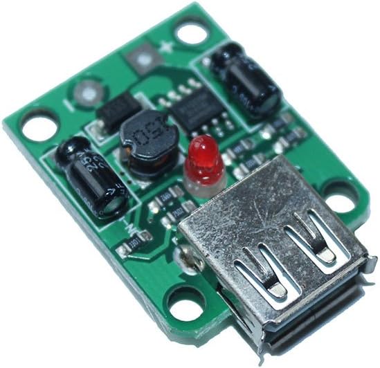

    So what you CAN DO, is setup the solar panel, the ones you have or another set, with a voltage regulator to provide a 5 volt (USB range) output. Since solar panels don't HAVE TO make power, the voltage regulator can be designed for the amount of current that will pass through it. In this manner you can use the charge controller built into your Phone to charge it. Better yet, you could charge a battery bank for those days when you have cloudy weather.
    Something like this (link below picture);
    https://www.amazon.com/jiang-5V-20V-Charger-Regulator-Charging/dp/B01MTJCOL6/ref=sr_1_9
    This will limit the output voltage of a 6-20 volt solar panel to a USB range and allow up to 2 amps charging if you have enough incoming current. You could combine this with a USB - Power bank to have extra power to charge your phone when you need to... This one is $6, and I've picked them up shipped from China on eBay for $1-2, just takes 6 weeks.

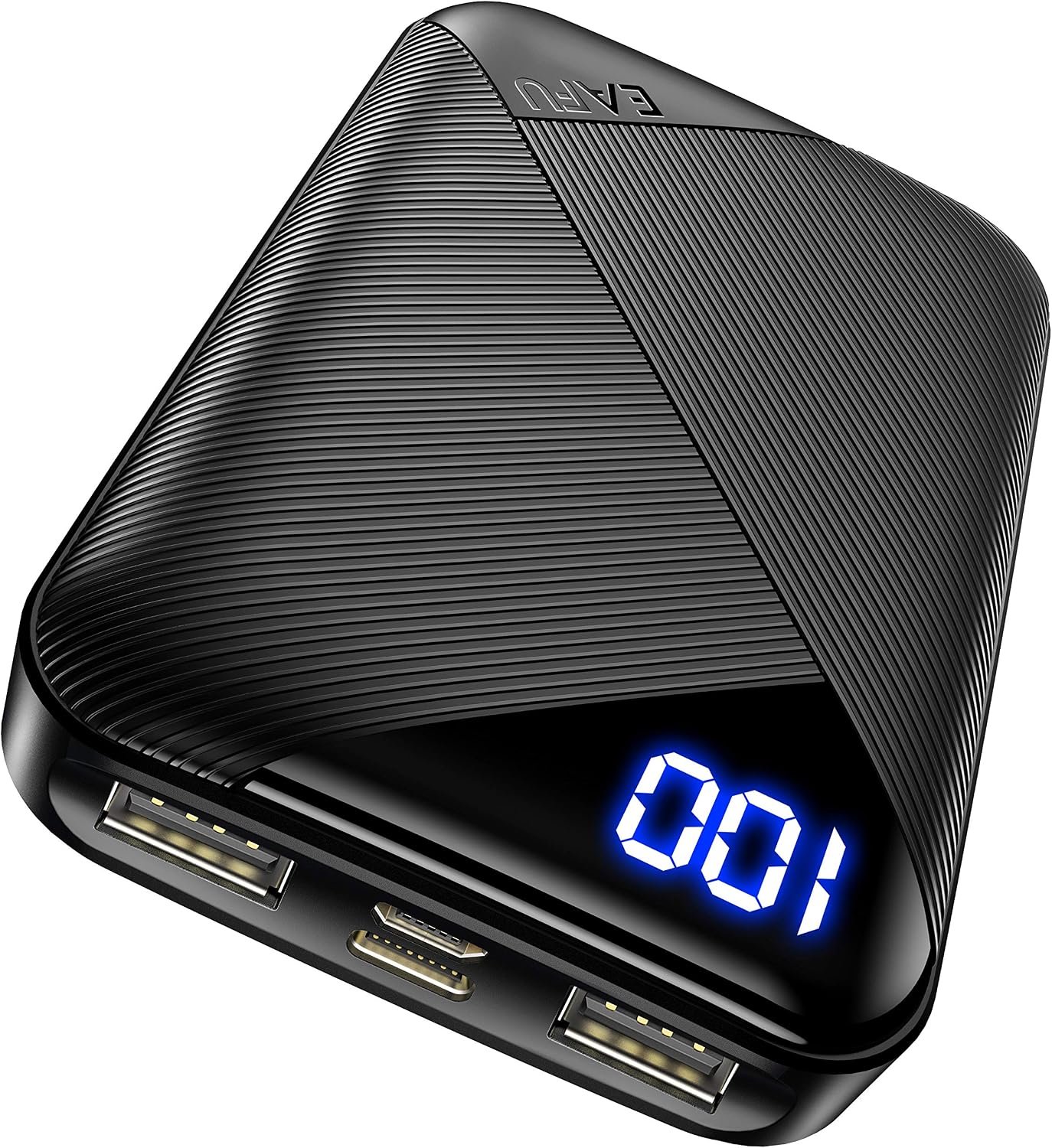

    You could, likely just add a power bank to your current PWM charge controller with USB ports and solve your problem;
    Ones large enough to charge a cell phone fully are likely 10,000 mah; and can be had for $10-20. Look around on Facebook market place, search for "power bank" likely you find someone selling reviews and selling the products.
    ...or here's one;
    https://www.amazon.com/EAFU-Portable-High-Speed-Flashlight-Compatible/dp/B07X64THC5/ref=sr_1_5

    I bought the Jiang regulator you linked to. It says its input range is 5 V to 20 V. Is that referring to the VOC? Because my 12V panel has a 23.6-V VOC. Does that mean I may fry it if I try to use that panel with this regulator?
    If so, then do you think it would solve the problem to instead use a converter with a higher maximum input range? I have these two converters I could use for this purpose.
    amazon.com/gp/aw/d/B07JZ2GQJF?psc=1&ref=ppx_pop_mob_b_asin_title
    That's the first one. It's made by Drok and has an input voltage range of 6 V to 32 V.
    amazon.com/gp/aw/d/B07H6YZ9XS?psc=1&ref=ppx_pop_mob_b_asin_title
    That's the second one I have and it's made by Ekylin and has an input range of 8 V to 52 V.

    Voc (voltage open circuit--I.e., no loads) and Vmp (voltage maximum power) are rated for "standard temperature and sunlight"--Or around 75F/25C... When panels get hot (under full sun and hot ambient temperatures with no wind), the solar cells get hot and Voc/Vmp falls (by roughly 20%)... Conversely, when solar panels get cold (typically very cold, well below freezing) their Voc and Vmp voltages can rise quite a bit... your 12 volt panel may very from 14.4 volts (Vmp-very-hot something like 40C) to 28-29 volts (Voc-very-cold something like -30C).
    So, in general, it is best to have a wide input voltage range for your solar panel loads/voltage converters... If you are running in moderate climate such as a tropical island or non-winter camping--Then you don't have the issues of Voc-very-cold and high Vpanel voltage.

    I suspect you would be fine, but don't know. For $5 I'd give it a go, as to the others working, likely they would beat least as good if not better, though some phones/devices are very picky about voltage regulation Apple/Nokia.
