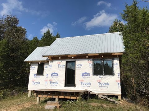

I just received my iron ridge mounting hardware that I purchased here, so figured I might as well start a build thread about my small off grid weekend place.  It's many years in the making, crazy to think I have a 10 year badge here and I'm not even close to done.  I've just completed part of the roof and hope to mount the panels if my solar feet arrive on time.  The cabin is built using advanced framing per building science corp. and is part stick framed part timber framed.  It has an R 39 roof that is vented and will have a mix of R19 and R32 walls that are also vented via site build rain screen.  The solar setup will be 260 AH at 24 volts powered by the Bogart controller/trimetric combo with 640 watts of solar and room for another string if usage ever increases.  I have loads of videos on the build so far so check out my Chanel.  This one I posted is my best edited one so far.

    I'd wrap that OSB before nature reclaims it.

    Well we did finally get the OSB wrapped.  The water off the roof is splashing off the deck and soaking it.  We really need some gutters.  Anyway, we just got our doors and windows in.  They are Marvin Wood Ultrex.  If anyone is building I really like them but they are pricey.  Low e is standard though which is nice.  Video update below.

    Think about cladding with steel, low maintenance, lasts forever, wood is a PITA if you ask me, but then again I'm a practical person.

    I'm strongly considering doing a wainscoting strip using the same galvalume we used on the roof.  It would take all the splashing that hits the bottom half of the cabin.  Gutters are great, but in the woods they come with their own issues.  Fire isn't much concern, we're in the midwest, and we get a good deal of rain almost all seasons.  We used to have a dry season in late June/July/August, but honestly that doesn't happen any more.  All that said, I do take out one or two junipers near the cabin each trip and get them to the burn pit.  Next trip I'll probably get the panels up on the roof.  They are currently in the loft and well, I don't want them to walk away.

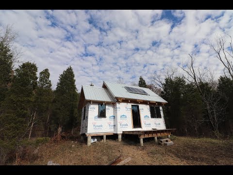

    Well this is an exciting time.  After 10 years or so of wanting to install solar, got my second batch of equipment in the mail from NAWS and started installing the panels!

    I made a video chronicling my solar install,  it's more of an entertainment video than a technical one.  I've still got a bit of work to do but thankfully done climbing on the roof.

    Did you drill a weep hole in the bottom of the right angle pull box at the wall? I have a bit of concern that water could follow the wiring/conduit and bring water inside the cabin.
    Generally, a weatherhead with drip loop keeps things a bit drier...

    I didn't drill a hole, but thats a pretty easy precaution to take.  I thought about using a mast, but didn't want to drill through the roof if I could afford it.  The way that I did the strapping under the roof would have made it tough to get a tight seal with any gasket because I wouldn't have any wood to drill into in some parts.

    I'm curious what your plan is for good air sealing (Tyvek doesn't usually test out well, even when fully taped).

    I'm just accepting a moderate level of air sealing.  We've been caulking seams, using sill sealer, foaming gaps, etc and will also tape the tyvec.  Basically going into it knowing we won't achieve a super insulation level of air sealing.  That said the small size of the structure means that we have some margin when it comes to heating and cooling.
