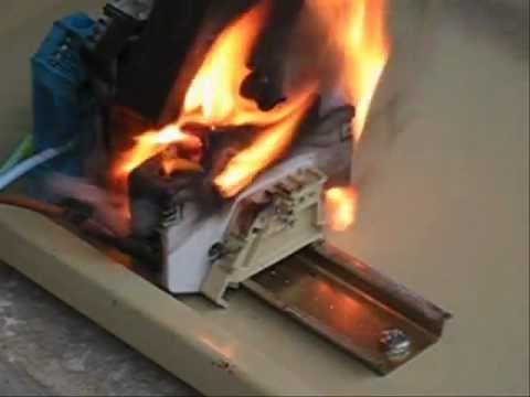

  • BB.
    BB. Super Moderators, Administrators Posts: 33,745 admin
    One BIG WARNING about using touch safe fuse holders--They are not designed to "turn off" the electrical current.
    If "you" just pop the fuse in the middle of the day, without removing it, it can cause an arc and eventually destroy the fuse hardware.
    Only pop working touch safe fuses at night, or by turning off the loads (charge controller/etc.) first.
    https://www.youtube.com/watch?v=ghBBW9aytzk
    -Bill
    -Bill
    I totally agree. There is a load center with switch rated dc breakers next to the charge controller. There needs to be some form of over current protection in the combiner box though,  either fuses or dc rated breakers.
