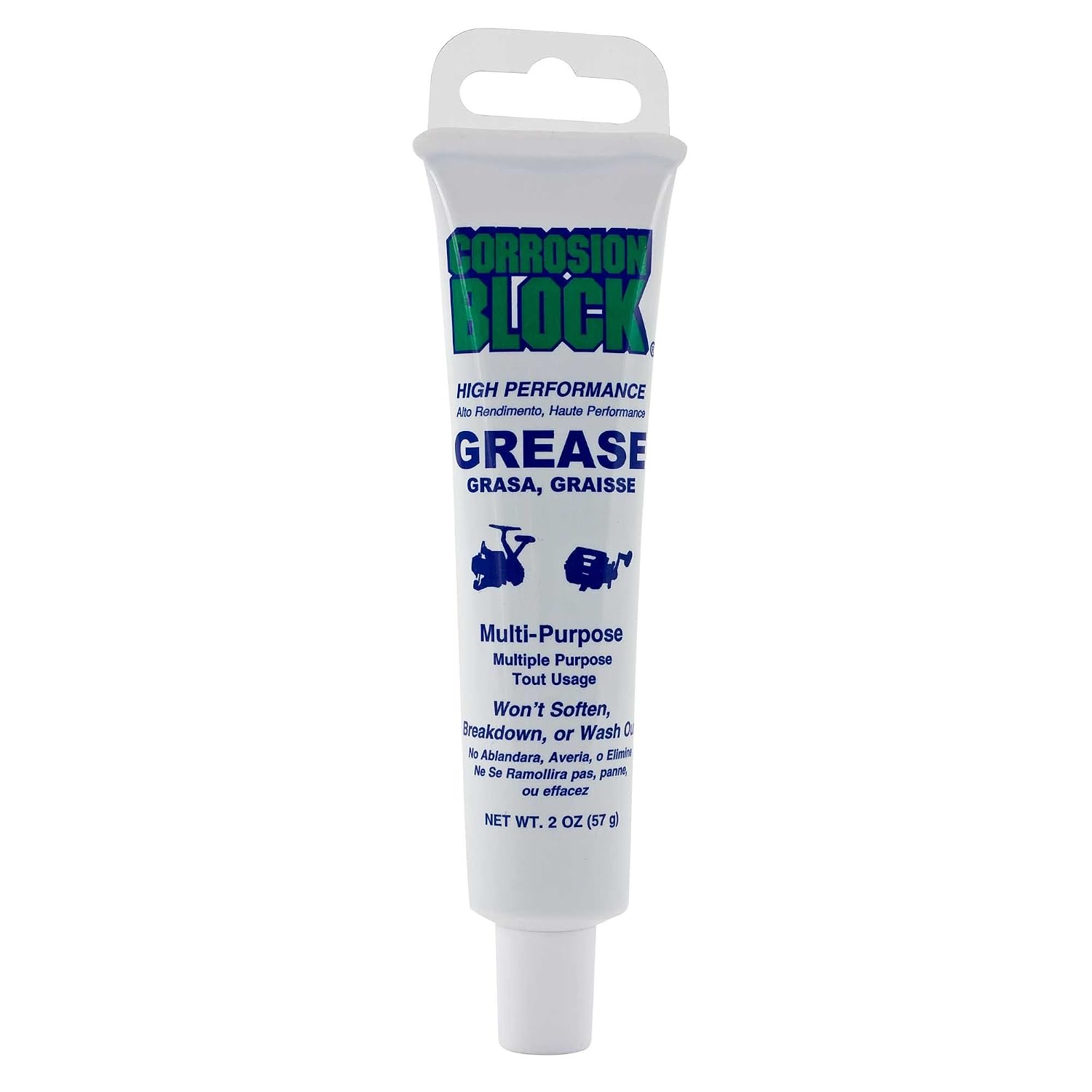

On connections I have always used Lear products corrosion block grease or spray depending on the location.
