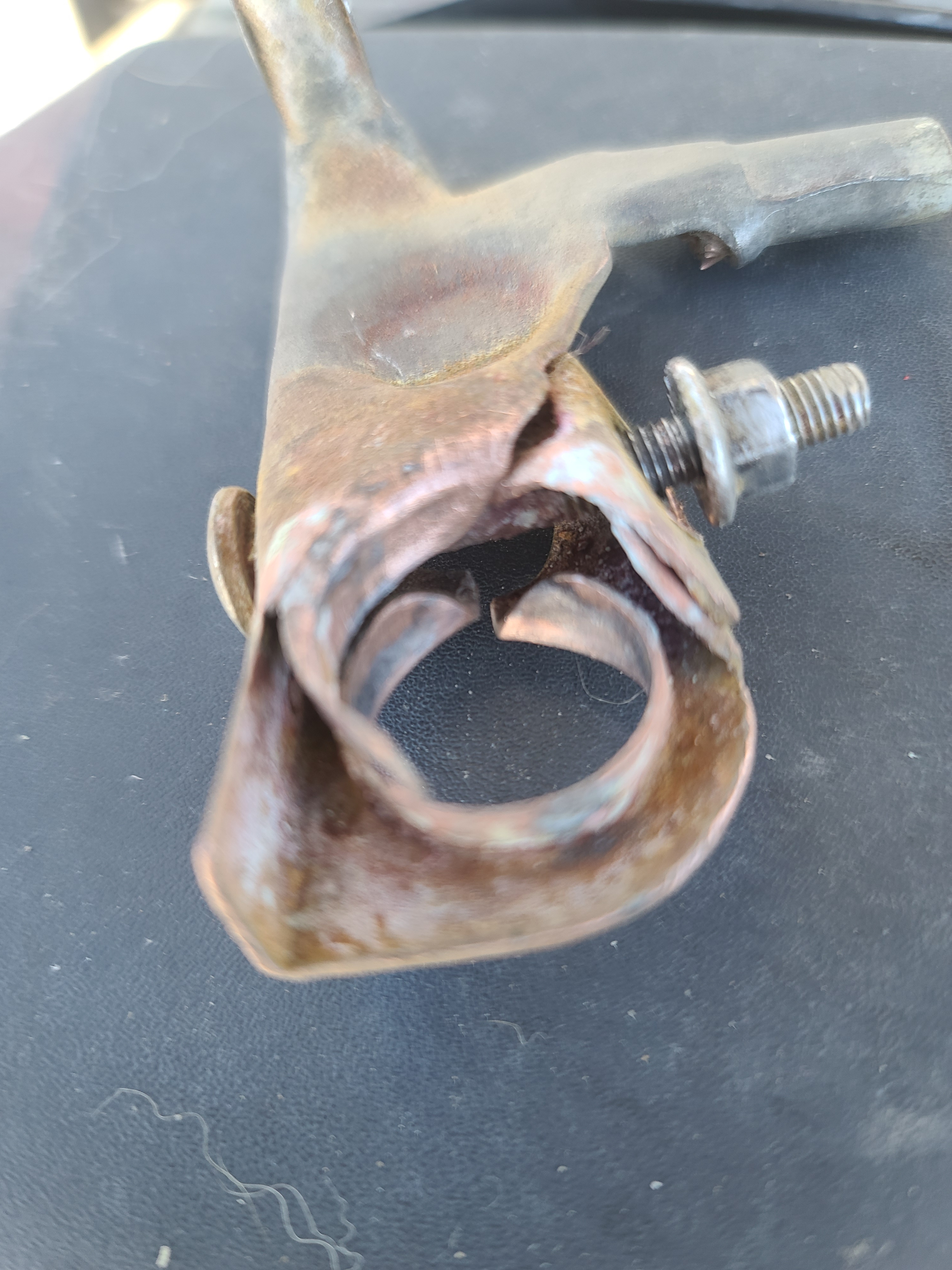

Solving a bad battery connection on a car.
Sounds like the Battery is going weak/failing... And mostly starting on battery surface charge(?).
I have a daily driver car with a ~5 year old battery... Getting weak, but still starts car (mild climate, San Francisco area).
A pickup that had a 6-7 year old battery that was hardly driven, but on full time maintenance charge with this charger:

Seems logical. We’ll see how it responds to a truly full charge. If that works - time for a new battery!First Bank:16 180 watt Grape Solar with FM80 controller and 3648 Inverter....Fullriver 8D AGM solar batteries. Second Bank/MacGyver Special: 10 165(?) watt BP Solar with Renogy MPPT 40A controller/ and Xantrex C-35 PWM controller/ and Morningstar PWM controller...Cotek 24V PSW inverter....forklift and diesel locomotive batteries
Truly full charge made no difference. Recently tested ~600CCA which should be plenty for a 302CID engine. Guess I’ll try a different battery still.First Bank:16 180 watt Grape Solar with FM80 controller and 3648 Inverter....Fullriver 8D AGM solar batteries. Second Bank/MacGyver Special: 10 165(?) watt BP Solar with Renogy MPPT 40A controller/ and Xantrex C-35 PWM controller/ and Morningstar PWM controller...Cotek 24V PSW inverter....forklift and diesel locomotive batteries
Did you clean the cable end too? Probably you did, but you didn't mention it.Sol-Ark 12, 3 Pytes V5 100ah batteries, currently 12 REC 420w panels installed.
It sounds like the battery itself may still be fine, but the positive terminal or cable likely has internal corrosion or damage that’s causing a high-resistance connection under load. That’s why small things like the radio work, but the moment the starter needs real current, the connection fails even after cleaning. Often the corrosion travels inside the cable under the insulation, so it looks clean on the outside but can’t carry amperage. At this point the best move is to replace the positive cable or terminal entirely, because if cleaning no longer restores a solid connection, the metal is probably too compromised to reliably carry starter current.

Sounds very plausible given the batteries 630 CCA and 4.5 resistance. Yet replacing it yielded a couple easy starts so far.johnsmith76 said:It sounds like the battery itself may still be fine, but the positive terminal or cable likely has internal corrosion or damage that’s causing a high-resistance connection under load. That’s why small things like the radio work, but the moment the starter needs real current, the connection fails even after cleaning. Often the corrosion travels inside the cable under the insulation, so it looks clean on the outside but can’t carry amperage. At this point the best move is to replace the positive cable or terminal entirely, because if cleaning no longer restores a solid connection, the metal is probably too compromised to reliably carry starter current.

Btw, the specs for my 2013 truck's 302CID engine calls for a 750 CCA battery.Sol-Ark 12, 3 Pytes V5 100ah batteries, currently 12 REC 420w panels installed.
So far so good with battery replacement. Still say that 630 CCA should also have started it. It starts real easy as a rule.First Bank:16 180 watt Grape Solar with FM80 controller and 3648 Inverter....Fullriver 8D AGM solar batteries. Second Bank/MacGyver Special: 10 165(?) watt BP Solar with Renogy MPPT 40A controller/ and Xantrex C-35 PWM controller/ and Morningstar PWM controller...Cotek 24V PSW inverter....forklift and diesel locomotive batteries

Been working perfectly with a newer battery. Still say the older 630CCA battery should have at least tried a little. It either started it, rarely, or did absolutely nothing except for turning on the radio.Could be internal cable resistance of course.First Bank:16 180 watt Grape Solar with FM80 controller and 3648 Inverter....Fullriver 8D AGM solar batteries. Second Bank/MacGyver Special: 10 165(?) watt BP Solar with Renogy MPPT 40A controller/ and Xantrex C-35 PWM controller/ and Morningstar PWM controller...Cotek 24V PSW inverter....forklift and diesel locomotive batteries
So the connection failed again. Took
it apart and found a lower arm missing.
Replaced and it worked with loose connections. Tightened them and now it works sometimes. Ugh.First Bank:16 180 watt Grape Solar with FM80 controller and 3648 Inverter....Fullriver 8D AGM solar batteries. Second Bank/MacGyver Special: 10 165(?) watt BP Solar with Renogy MPPT 40A controller/ and Xantrex C-35 PWM controller/ and Morningstar PWM controller...Cotek 24V PSW inverter....forklift and diesel locomotive batteries
