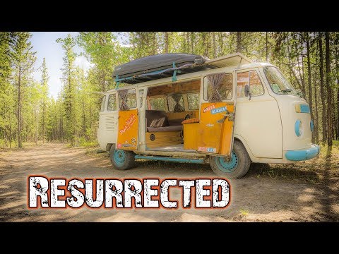

This couple spent a few years traveling by van from Chile to the Prudhoe Bay, Alaska. While spending months away from the van, due to expired Visa, the lithium battery caught fire. The interior of the van was almost destroyed.
Well done little amateur travel videos and 15 of them. Seems they lived off of Patreon donations from those who "lived the dream" vicariously. I am amazed when a couple is able to pull that off. Many try, no idea how many succeed.
Wondering what probably caused the battery fire? Rodents caused a wiring short maybe? Rogue battery overcharged? CC malfunctioned? What say you?

I may be a complete fool, but that looks like the early type 2a, with a <50hp motor, I can't image!
I had a 73 transporter with the 67 hp pancake motor, It was a bit under powered, at the same time I had a Yamaha XS750 Motorcycle that had more horsepower. Can't imagine tackling the Al-Can hwy.

It is a '92, he called it a POS many times. I think the motor was overhauled 8 times? He finally learned how to do it himself. On a 5 year trip, he spent about 1 year in mechanic's shops.Photowhit said:I may be a complete fool, but that looks like the early type 2a, with a <50hp motor, I can't image!

This picture may help our detectives. Think a fuse in front of the positive terminal may have helped? I don't know if one was used. His father is an electrician by the way....I would assume that he has some knowledge in that area since he has worked for his dad.
First Bank:16 180 watt Grape Solar with FM80 controller and 3648 Inverter....Fullriver 8D AGM solar batteries. Second Bank/MacGyver Special: 10 165(?) watt BP Solar with Renogy MPPT 40A controller/ and Xantrex C-35 PWM controller/ and Morningstar PWM controller...Cotek 24V PSW inverter....forklift and diesel locomotive batteries -
Looks like a DIY battery made from used 18650 Lithium Cobalt (LCO) batteries which are the most likely to catch fire.
I can't see any evidence of a BMS. It was also being charged via the solar panel while it was sitting for a long period of time.
These factors added together make it a recipe for a disaster.
Firstly, the fact that they are used cells probably from different computers, from different manufacturers and different ages and usage history means that they are more likely to go out of balance over time.
Secondly the fact that it was being charged on a daily basis via the solar panels probably without any loads on it would mean that the battery was at a high SOC most of the time which would have made the balance problems even worse.
Assuming the problem was not caused by an external or battery wiring short or a fault in the solar controller I think it is likely that the battery slowly went out balance over the months it was left standing on charge which would have meant the voltage on some of the cells would have risen to dangerous levels which would have raised the temperature of those cells to the point where they caught fire.
If the battery had a BMS it would have stopped it being charged when it had gone too far out of balance and/or kept the battery in balance. Alternatively if the battery had been disconnected from any loads and the solar controller it would have been OK.
To me this is more evidence supporting the importance of having a BMS. There are billions of computers, power tools and other devices in use which use the most dangerous lithium ion batteries. The reason that these devices work safely and don't catch fire is that all these devices have a BMS of some sort keeping the battery safe.
