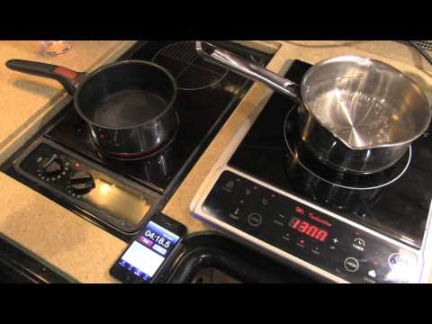

    BB. wrote: »
    You could do your own efficiency calculations--1 lb of water increasing 1 degree F is 1 BTU... 1 W 3.412142 BTU/hr
    Bill, on efficiency there is no comparison. The comparisons and calculations have been done by the US DOE, and many different labs, etc.. If you have no experience with induction cooking you have to try it hands-on before you will believe. This is a good comparison on a 1200 watt 240V Princess conventional electric ceramic cooktop vs a 1300 watt 120V Mr Induction heating the identical amount of water to boiling. The energy consumption of convection is over double on water heating
    [video=youtube_share;b8zXdPA9E6s]http://youtu.be/b8zXdPA9E6s[/video]
    In our own home, over the long term compared to our conventional electric we had before, the induction uses about 75% of the energy that the conventional did. Gas is less efficient yet based on BTU input to the burner vs heat to the food. It is a known fact that has been tested and documented over and over.
    Chris

    This is our little induction cooktop out of our camper.:
    Attachment not found.
    It goes to to 1300 watts and has an infrared sensor in it like our big cooktop on the range that precisely sets and holds the temperature in 10 deg increments. Typically, when we use this thing to cook breakfast for two (hotcakes, eggs and sausage or ham) Kristin runs it on the 275-300 degree temperature range and it draws about 800 watts. She'll have it running for maybe 15 minutes to cook breakfast for two. So I would estimate it uses roughly 200 watt-hours for that.
    We have run it with a 3,000 watt AIMS inverter and a single 12V Group 29 marine deep cycle battery before with no problem at all, along WITH running an electric coffee maker. If the battery is fully charged it will "sag" to about 11.7 volts while she's cooking and coffee is brewing. But as soon as she turns it off the battery recovers right away and if the sun is up the solar panels on the camper got the battery voltage back where it was before she starting cooking breakfast within an hour and a half. And that's just with two 80 watt 12V Sharp solar panels.
    We have stayed in Canada on a 10 day fishing trip before, totally off-grid and with no generator, using that little induction cooker every day. And never ran the batteries down below 50% for the whole 10 days. Although we do put in two big 4D's in the generator compartment when we go to Canada with it.
    Chris
