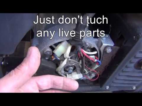

    Your genset voltage regulator is extremely highly likely to be adjustable - AVR. It is probably easily located at the "end" of the motor. Remove about four screws to remove the motor "cap". Then another couple screws for the voltage regulator. There is a very, very small brass screw that will allow you to very easily lower the voltage.
    I did this a couple months ago. Going from memory - could have a small detail off. Like number of screws. https://www.youtube.com/watch?v=bjHgH7k-Hu0

    Also your Hz: "Good video. For others finding this video, first make sure your generator is running at 60hz (if you are in the US) before you adjust the voltage regulator as shown in this video. Either use a "kill-a-watt" meter or a multimeter that can read hz, start the generator and adjust the phillips spring-loaded screw for the governor adjustment to get the hz as close to 60hz as possible. You may find that you need to set the hz to 61-62 range unloaded to get a solid 60hz under load. Once that's set, follow this video to get your voltage dialed in."

    The Honda eu2000i is an inverter-generator... The inverter is fully electronic and (as far as I can guess) does not have any "mechanical" adjustments for voltage and line frequency.
    With inverter-gensets, the motor generates "wild AC" (variable 3 phase voltage and frequency... Usually converted to DC then "inverted" to 120 VAC 60 Hz).
    -Bill
  • mike95490
    Options
    He's dealing with an INVERTER generator, not a regular alternator.   The inverter module may be totally sealed (how do you adjust the inverter output voltage on your 2kw inverter ?)
     The engine runs at different RPM's according to load.

    Alright then - perhaps an Hz adjustment is possible then?

    In searching around, I saw references to a small pot on the AVR to alter voltage on larger honda inverter type generators.  I didn't find anything on the 2000i though.
    Maybe the AVR is integrated and non-adjustable on that model like Mike said?  I couldn't find a separate replacement AVR part for the 2000i, which suggests integrated to me.

    Inverter genies are not AVR controlled, and not adjustable in a traditional fashion.  HZ adjustment as well.  In traditional gennies HZ was a function fo RPM.  In my old Lister, you adjusted freq by changing the rpm, 1800=60hz.  You adjusted the voltage by changing the pick up point on a variable resister that excited the field.
    thanks folks, the extension cord works just fine, if inelegant.  Hopefully Honda can provide an answer, but I’m not hopefull.
