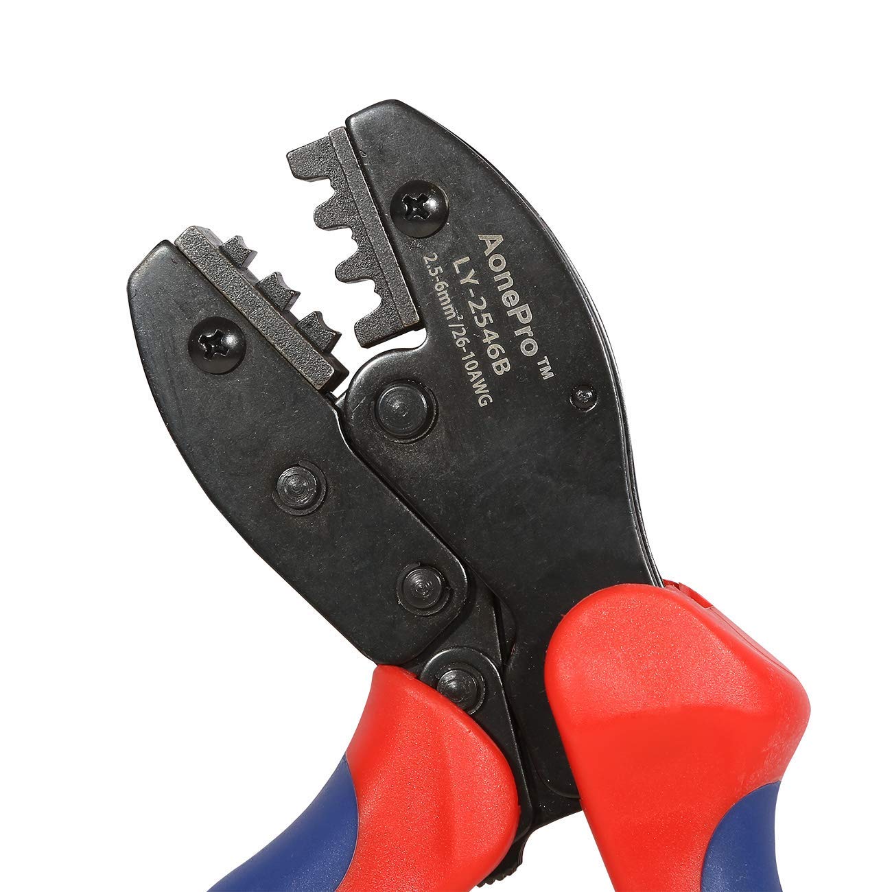

    Not sure if you will be making your own cables?
    Officially you should use the Code compliant tools, but I know what a good crimp looks like and choose to use a cheaper tool. These days they make cheap tools that function similar to the code compliant tools. with the dies being pressed together straight up and down. These work better than the tools that are hinged (like the cheap tool I bought 10+ years ago) I know I've used them both!
    Don't buy this!
    Go for something like this instead;
    Link;
    https://www.amazon.com/VIKOCELL-Crimping-Connector-Terminal-Crimper/dp/B0727P5PK7/ref=sr_1_8
    Shows the 2 different types in operation;
    https://youtu.be/fTUWW1sXJf8
    Also important if you are going to make your own cables, be sure to get the higher strand  wire, The cheapest stuff is often USE2 7 strand wire, it's a PITA to crimp, I got to the point I just fanned the wire  out clipped 1 of the strands, then careful made sure the others were 3 x 3 into each side of the crimp.... Seriously!  PVwire is typically(always?) 21 strand and much easier to crimp.

    Thanks for the tip on the crimper. I did intend on doing my own crimps because if this works out, I'll likely do it again at least once or twice...

    The blue one works great. Done many hundreds of crimps, if not tens of hundreds. Photowhit is right about the other type. They don't work as well. There's some tutorials on youtube walking you through crimping the MC-4 connectors. Good thing they're cheap because you're bound to do a few wrong while you're getting the hang of them.  Once you snap in the contact you cannot get it back out.  Remember, Male contact into female MC-4 housing and Female contact into male housing. I say male and female housings because the male isn't necessarily the positive  and vice-versa. The male on the back of the solar panels is the positive but when you are making extensions the female connector connects into the male output and has a male connector on the other end or whatever type on termination you require for the combiner, charge controller, etc..
