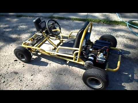

Hello all,
I build electric go karts.  Here is one of them.  https://www.youtube.com/watch?v=uBMA10WYGsI
I am interested in setting up a solar battery charger for them.
The batteries I am using are (4) 12V 12AH SLA's. I would like info on how to properly set up a 48V solar battery charger.
I have looked @ these "cheap" 100W panels from Harbor Freighthttps://www.harborfreight.com/100-watt-solar-panel-kit-63585.html but, as I understand they are for or to charge @ 12V.
Would I need (4) of them ($600.00-$800.00), wired in series, to charge my 48V battery packs?
Any suggestions on "better" alternatives?

    Don't get those Harbor Freight panels... They are not very good.
    The only off the shelf 48 volt battery "boost" controller that I know of is this guy "GVB-8" 8 amp charger:
    https://genasun.com/all-products/solar-charge-controllers/for-lead/gvb-8a-pb-solar-boost-controller/
    You will probably have to contact Genasun directly to confirm what the input voltage range is... I believe it can take Vmp~30-36 volt panels... I am not sure it can take a 12 volt panel for 48 volt battery charging directly.
    One charge controller and one ~200-350 watt panel and it could give you an alternative to 4x 140 Watt "12 volt" (Vmp~18 volts) set of panels.
    Normally, >200 Watt Vmp>=30 volt panels are 1/2 the cost ($$$/Watt) of 140 Watt Vmp=18 volt panels.
    The other question is how much current do you need to recharge your batteries... Normally, 10% to 13% rate of charge would be the nominal charging current (1.2 amps to 1.6 amps for a 12 AH battery bank). Higher than that could start to give you battery bank overheating issues. For example:
    • 12 AH battery * 58 volts charging * 1/0.77 panel+controller derating * 0.10 rate of charge = 90 Watt nominal solar array
    I don't know if the GVB-8 can recharge a 48 volt battery bank from a single ~90-140 Watt Vmp~18 volt panel.

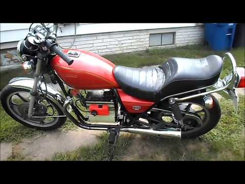

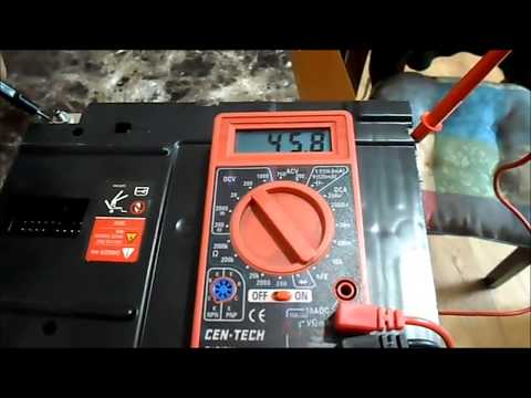

    Very good points, I hadn't thought about the SLA's sitting partially charged overnight. (over & over again)
    I'm glad you brought Lithium up. Yes, I have done tons of research on Lithium batteries.
    I have just purchased a 2kWh section of a 2015 Chevrolet Volt battery pack for a motorcycle that I converted over to an 8 kW electric motor.
    https://www.youtube.com/watch?v=ePoG8xfocEY
    https://www.youtube.com/watch?v=nBU6qdzbzdc
    but, it's nominal voltage is ~45V not 48V so it needs a "special" charger.
    From what I understand,
    These 2kWh sections are 45V with a capacity of ~47AH
    ...they were made by LG Chemical
    ...chemistry is Lithium Maganese Oxide (LiMg204)
    ...they have 3 pouches in parallel & then 12 cells in series (3P12S)
    ...basically, 12 cells in series
    Special requirements
    Since these battery packs nominal voltage is 45V (3.75V per cell nominal)
    The "safe" voltage range of this battery pack is 3.0V per cell (low) to 4.1V (36V low & 49.2 high)
    It can only be "safely" charged to ~49V NOT 51V+ like most common 48V chargers will do.
    So, it needs to have the top charge (cut-off) set at ~49V
    Any info or help on "safely" charging this battery pack will be greatly appreciated

    This isn't really a "solar" question but, just a "charging" question
    I ordered a 600W/10A lithium battery charger & asked for it to be "preset" to a 49V top charge.
    (for use on my 45V Volt battery)
    I ran my motorcycle until the battery was discharged down to ~43V
    When I connected the battery charger the voltage level of the battery pack does not increase or change.
    I have checked all of the connections & even double checked the (2) fuses in the charger itself.
    Any idea why, is it not charging the battery pack back up to ~49V?

    Have you checked the open circuit voltage on the charger output?
    Off-grid.
    Main daytime system ~4kw panels into 2xMNClassic150 370ah 48v bank 2xOutback 3548 inverter 120v + 240v autotransformer
  • Functional_Artist
    Functional_Artist Registered Users Posts: 17 ✭✭
    Options
    Yes,
    While checking the polarity, to connect the charge port, the meter showed 47.6V
    ...which I thought was odd
  • Estragon
    Estragon Registered Users Posts: 4,496 ✭✭✭✭✭
    Options
    Seems a bit odd to me as well. I know you said you checked all the connections, but problems can be really frustrating to find, and may only appear under load (bigger than the tiny current a multimeter uses). Do you have anything (eg 4 x 12v filament light bulbs in series) other than the battery that could be used as a load?
    Off-grid.
  • Functional_Artist
    Options
    Yes,
    I can rig up (4) small incandescent, 12V light bulbs in series or I even have a small 48V 1,000W motor available too.
    What do you have in mind?
    The connections:
    I have a female XLR connector "charge port" mounted on the bike. The charge ports positive (+) 10g. wire, connects to the Batt side of the circuit breaker (& then the energy goes via a 4g. cable that's connected to the same terminal, straight to the battery pack positive (+) terminal)
    The charge port negative (-) 10g. wire, goes straight to the battery pack negative (-) terminal
    Checking the connection:
    I get the same voltage reading from the charge port connector, (where the charger plugs in) as I do straight from the battery packs positive (+) & negative (-) terminals.

  • Functional_Artist
    Options
    The battery pack started off at ~49V. While riding, I discharged the battery pack down to ~43V.
    To connect the charge port properly, I needed to check the polarity of the charger, find out which pin was positive (+) & which one was negative (-) that's when I got the 47.6V reading (right from the charger output plug)
    I assumed the charger output plug would show ~49V but, I'm not sure how this charging stuff works because I've read something about needing to apply a "higher" voltage to get the battery pack accept a charge.
    When I attached the charger & turn it on, (1) red light comes on & (1) green light comes on. (like charging is complete)
    But, I know charging isn't complete because the voltage meter, on the bike, reads ~43V
    ...& my multimeter also show that the battery pack has ~43V too
    According to the manual, when charging there should be (2) red lights on
    ...& when charging is complete there will be (1) red light & (1) green light.
    I am not sure about current value or time but, I left the charger connected for ~2hrs.
    I thought maybe, it takes a minute to kick in or something
    ...but, after ~2hrs, I checked & the battery pack voltage was still right at the same ~43V
