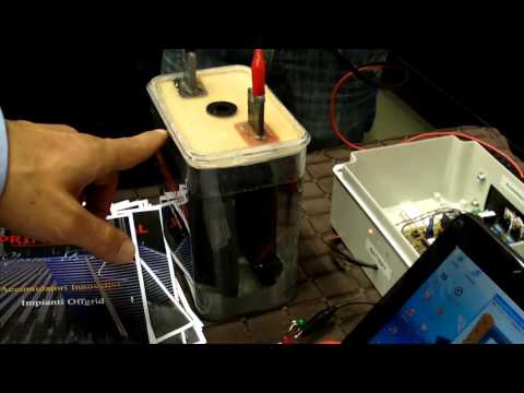

Has anyone made their own lead acid batteries, and can share some about their result on this? It's a toxic dirty process, but I'm planning to give it a try this year. The reason for this is that I want to find a way to constantly recycle my batteries when they fail, and I have the time and facilities to do it.
I will try the Plante process, where you start with sheets of lead and form them through many cycles of charging/discharging and reversing polarity. The batteries will not get anywhere near the capacity of factory made ones, but most likely they have a much longer life span. Perhaps in the order of a 1/4 capacity and 4 x lifespan. Can describe the manufacturing method here if anyone is interested.
With all the new battery technology coming, I think lead acid will soon be an obsolete technology, so there will be a big surplus of lead that can be found cheaply.

    Yes I messed about replacing cells in GEL, (fibre glass soaked separators) some 10 years ago. And seriously looked into making my own lead acid.
    The Plante process is probably the best for DIY builders.
    There are several How to books on the Plante process.
    In General polypropylene containers are readily available and can even be made fairly cheaper to your own specifications.
    Polypropylene woven material is also easily obtainable and can be used as socks for each plate and acting as a plate separator, as it was always the comb plate separator that I struggled with in the past.
    Its all about weight, and what is movable safetly. I went with a max of 60Kg, 132lbs, 2v cell, but my amperage was only half that of a commercial produced cell of the same size and weight. But on the other hand I can use/clean/resuse each cell pretty well for ever, and certainly outlast the commercial boys.
    Its just the thought of doing 24 individual cells that can be daunting.

    Thanks clockmanfran, interesting.
    I bought Phillip Hurley's book "The battery builder's guide", but found it to be poor. Lots of practical details about casting lead etc in there, but no real science. And it seems like the author didn't have much experience in building batteries, because there are no real plans in there, and no numbers for what to expect.
    And Googling around I've found nothing of real value, except a few simple tests, but no one who really put time and effort into anything.
    Do you have suggestions for better books or sources of information?
    I've found a good source of polypropylene felt, commonly used for ground cover. Will use it as a plate separator.
    But still many questions remain, such as the details of the Plante method (what current, how many times, etc), what thickness of plates is a good compromise, the surface of the plates (how to increase the area), etc.

    I did not do any actual data tests, it was just my observations.
    I expected only a 1/3rd but got about 1/2, its the Plante process, the more you add oxide to the plates the better it gets. I wire brushed my appropriate plates.
    I think the reason for better amperage is those polypropylene socks, it means I can get more plates tight in the available space, without using some sort of physical comb separator.
    There are many variables, sock leaching particles, plate wire brushing direction or random, weight of each plate, type of holding for each plate etc etc. So a heck of a lot of experimenting required.
    One day, when I get time, I might do a 'How to Make a Lead Acid Battery' to join my collection of 'How to Do' books.

    http://www.primordial.it/en/home-2/
    Here is the italy company. Youtube videos show he started making them in his back yard.

    Thanks for the info and the link to that Italian company. Couldn't find the video of him tinkering in his back yard though. But I found this video, where he presents a very peculiar looking battery, I assume it is a production model. There is no separator at all, and the plates are very far apart and in an unusual configuration.
    https://www.youtube.com/watch?v=SlyeXVmf3gw
    His main invention seems to be that he has found a way to cut down the time of formation from six months to two weeks. Maybe the physical layout of the plates has something to do with it. I assume it is a pure Plante process and not a Faure process.
