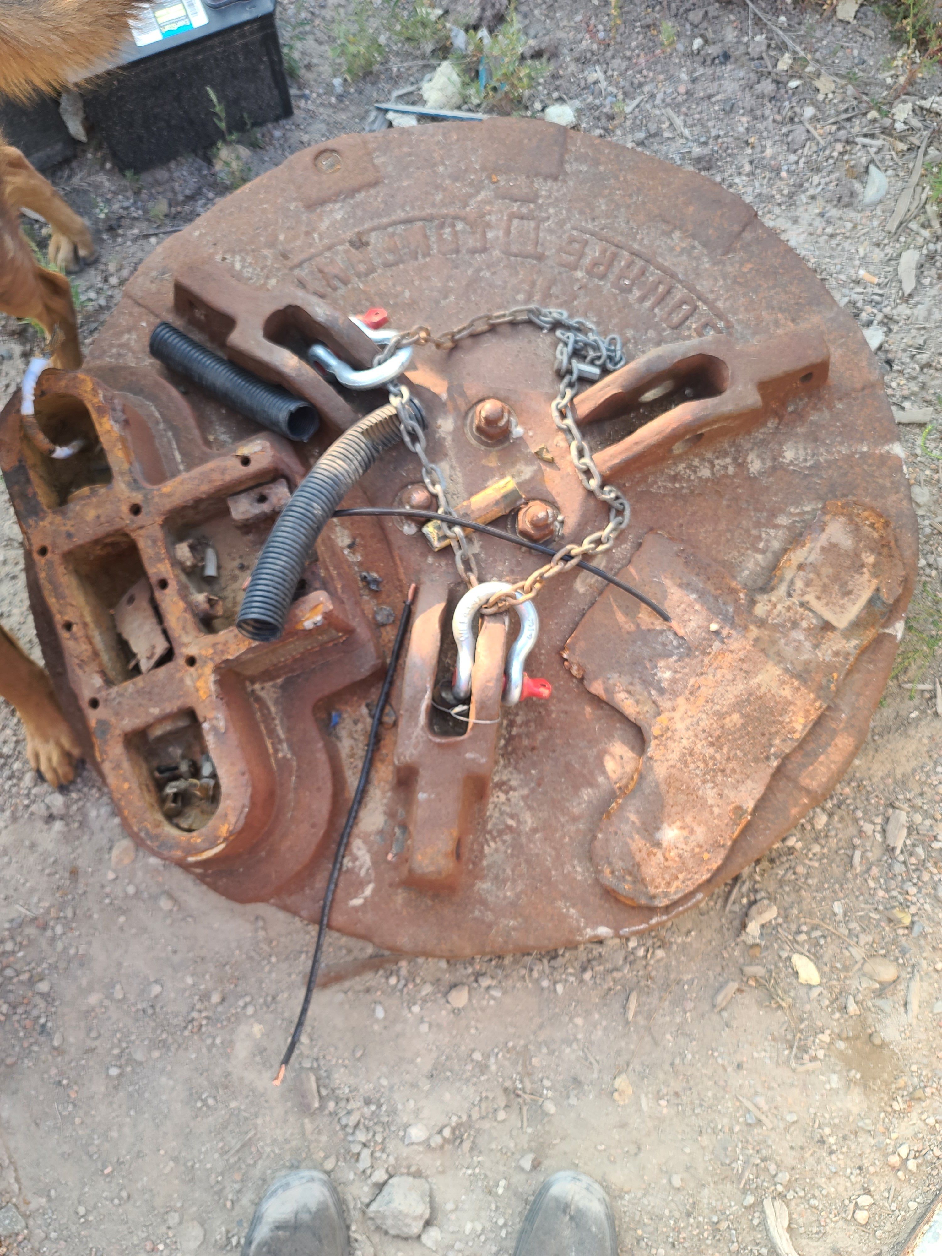

Electromagnet AC or DC?
softdown
softdown Solar Expert Posts: 4,082 ✭✭✭✭

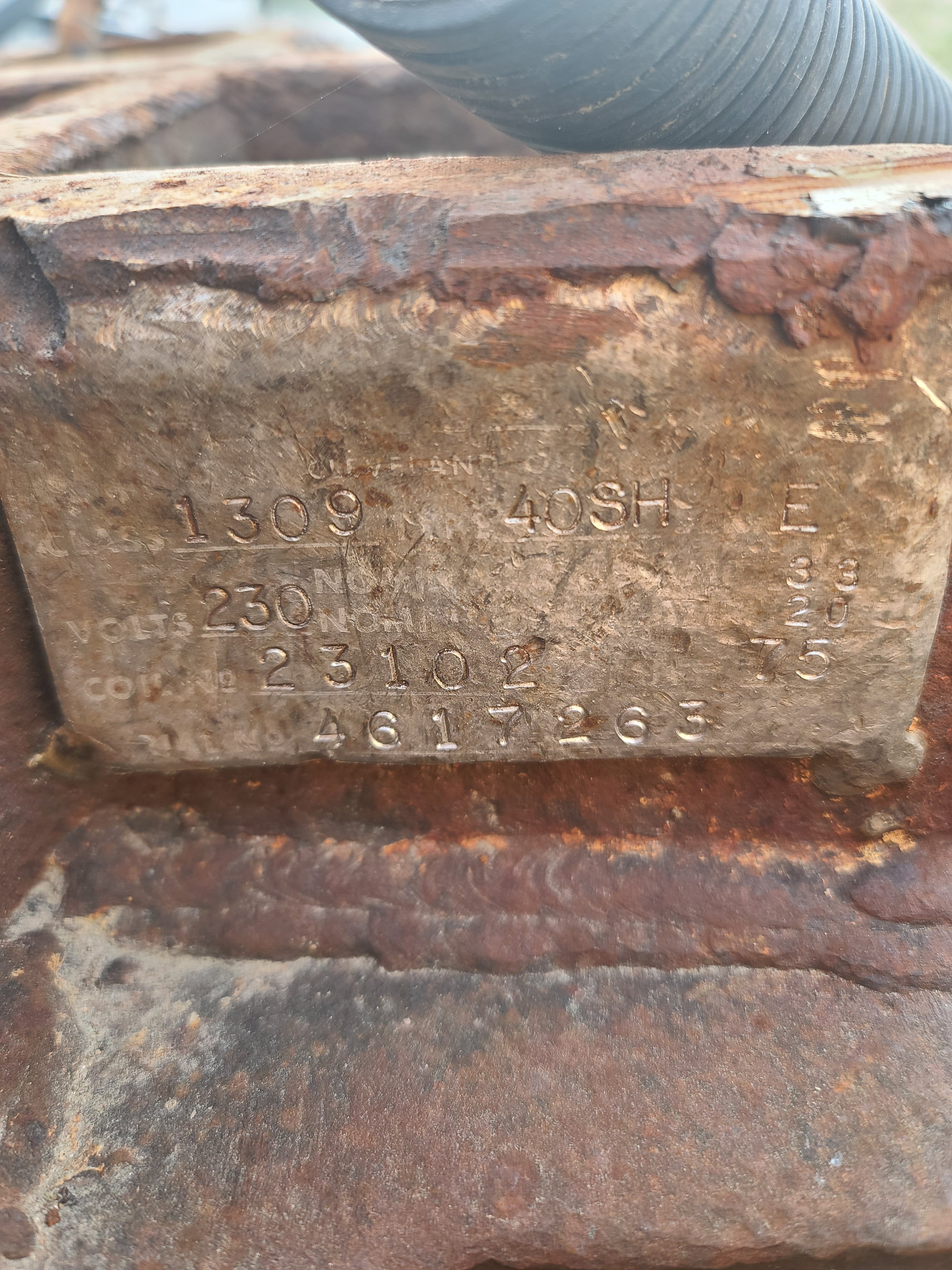

Can't find any info anywhere.
Can any smarties decipher the info plate at all?
  • softdown
    Auction ad said 240 volts. Owner said he never used it.

    Probably 230 VDC from what I can find quickly... There are also 24 VDC coil versions too (light duty). A "small" 230 VDC takes 12 amps (or ~3kWatts)....

    Ok thanks! I don’t know of any realistic way to supply 3 kW of DC power unless I buy an AC to DC converter.
    Since the strength of an electromagnet is dependent upon the supplied current, I would be inclined to suspect that more current would make a stronger magnet. The positive wire has a diameter of .427 including the insulation. Guessing that is about 1awg wire based on hazy memories.
    I would think the wire diameter would indicate the desired supply of current. Running on DC throws a wrench in what I can easily do.

    Unit is ~ 38” wide. Currently available and similar unit requires: 18 amps at 230 DC.  6 KW/6000 watts.

                My unit needs 18 amps at 230VDC. Quoted data below indicates a need for an ~ 5000 watt generator. That isn’t a problem. But turning the AC into DC is currently a pretty big problem.
                • "82 Cold amps at 230V DC
                • Requires min. 20kW generator”
                Their prices may be on the high end. Judging by this:"Used (2024) Skid Steer Scrap Grapple c/w dual hydarulic arms, lower bucket with bolt on blade, 73" wide x 34" depth - 24" high.  Comes with quick attach, hyd. hoses and fittings
                Price: $5,600 USD + shipping
                Still good to see that my magnet may have a value in the low thousands - with some additional parts. Made by Square D a long time ago. I would bet that it has copper windings - not aluminum.
                So I need a large rectifier. Sounds like a good start.
