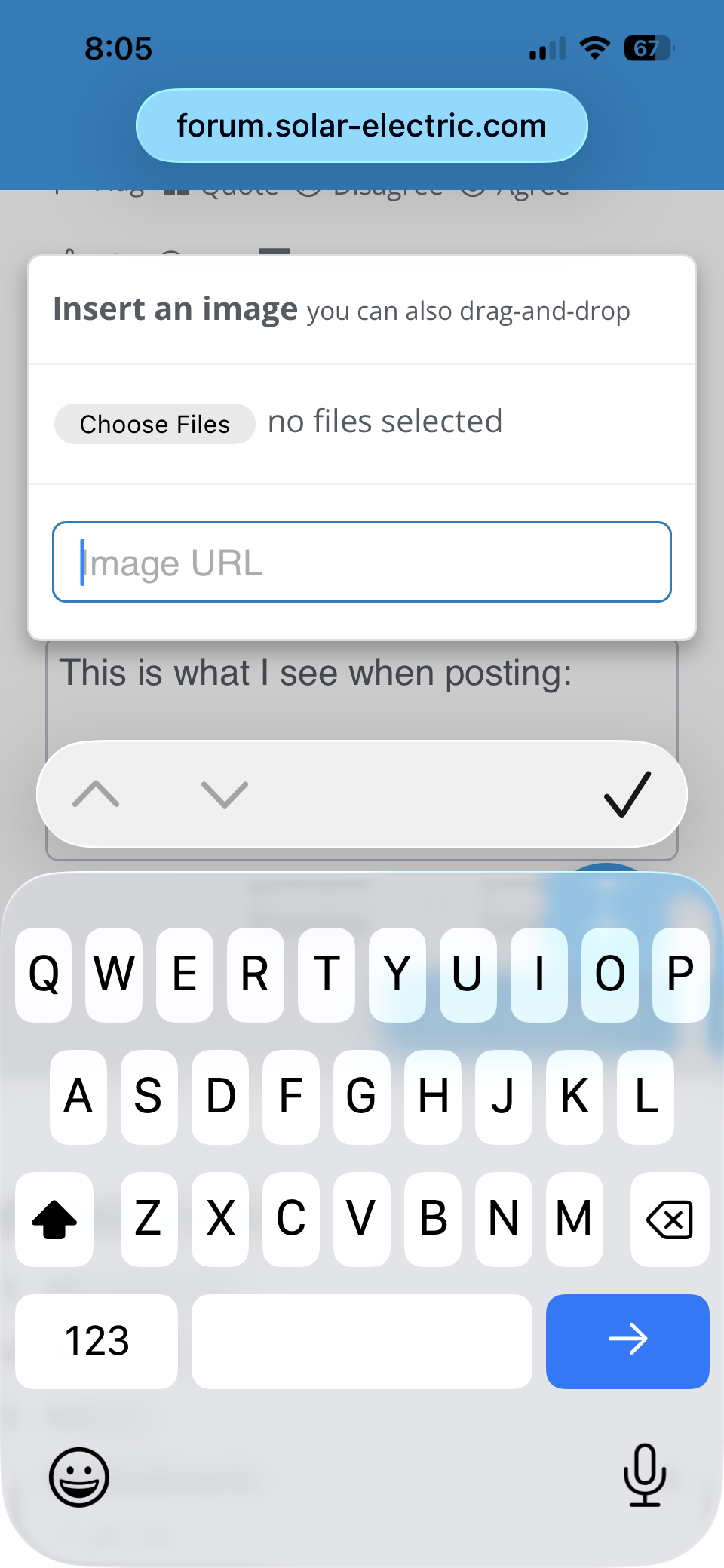

  • Wheelman55
    Wheelman55 Registered Users Posts: 275 ✭✭✭
    edited December 2025 #27
    This is what I see when posting:  note “choose files”. This is on iPhone 13
