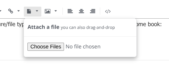

You should be able to post most picture/file types... For example a screen shot from my chrome book:
Drag and drop sometimes works too...
Generally the "photo" button I use for pictures. And the black sheet of papers for other text file types...
-Bill

BB I wish it was as simple for me to post pictures as it appears to be for you. It doesn't give me insert picture or attach a file options as you posted. It only give me the option to insert an image URL. Apparently I need to use something like Imgur to upload pictures and attach the URL for all of you. Sorry, what a pain!

OP. If using a smart phone, when you go to insert a pic, click on the “choose files” button. That’ll direct you to your phones camera as well as pics on the phone.It’s pretty straight forward.Off-Grid in Terlingua, TX

Wheelman, I logged in on my smart phone and it does not give me a "choose file " option. All the options are the same as when I'm using my laptop. So URL is my only option.

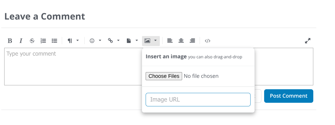

This is what I see when posting: note “choose files”. This is on iPhone 13

It doesn't give me that option. Now it won't even allow me to post a URL link. Sorry, I took several pictures but can't post them.
