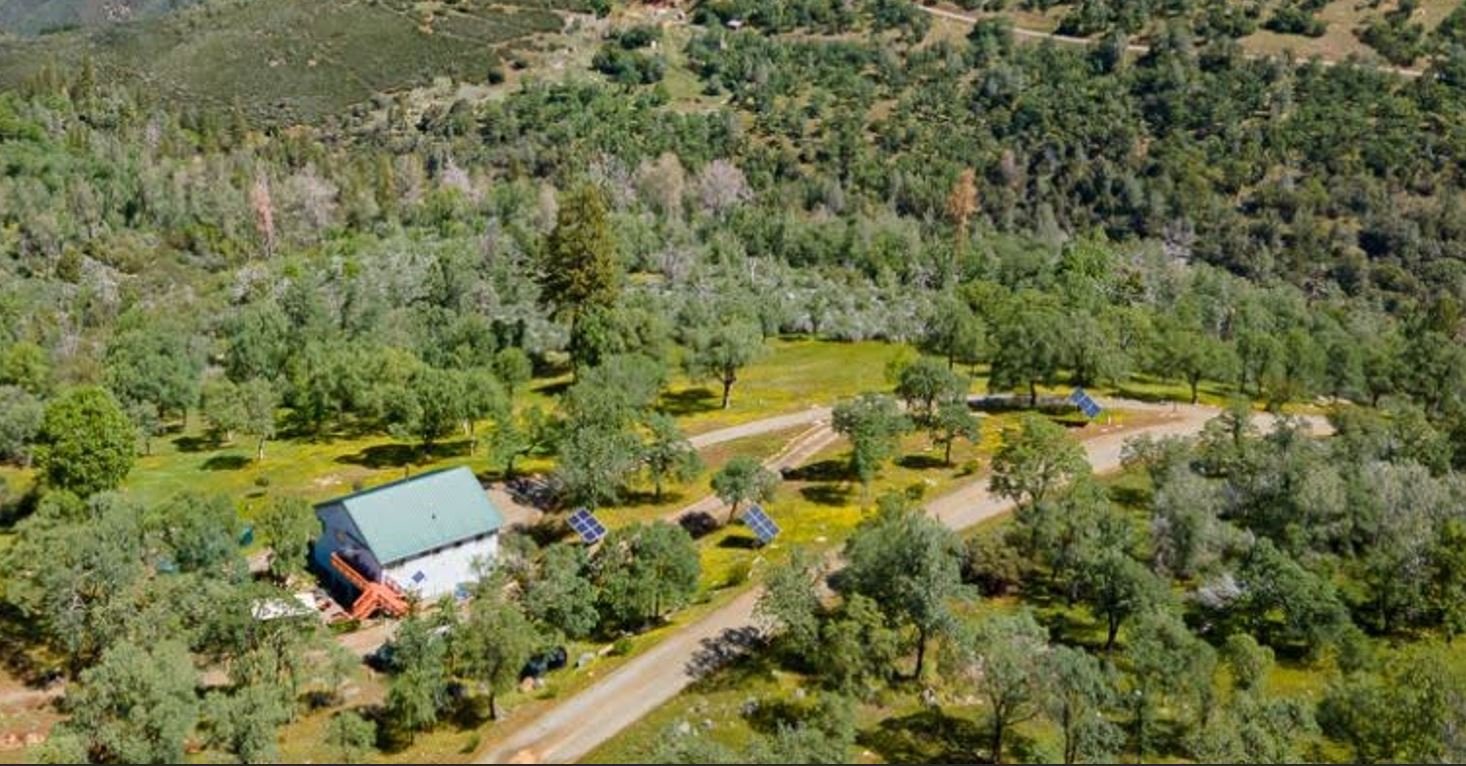

    Thanks for the comments and info from last year. The wind can get strong here during storms. Not as bad as the Santa Ana winds in Southern California.
    The Sol-Ark12 system from NAZ is running now. Only 6 of the 16 REC 420w panels are hooked up. I was getting by on a much smaller system and haven't discharged the 3 Pytes V5 batteries below 80% on this system.
    I used to run a generator a lot as I was using more power than what two very abused Trojan T-105's could store. The new system solved that problem. The current setup completely recharges by 11am! Of course it's very sunny this time of year. And I'll find ways to use more power now that it's available.
    The six PV panels are secured via the four 1/4" holes with bolts and washers, but I still need to install all 16 panels with a proper ground mount.
    I appreciate the warning that securing panels better will help prevent failure in high winds. I hadn't thought of exceeding the Mfr's mounting suggestions. I did consider using less tilt than recommended for a 35 degree latitude to lessen wind loads.

    @littleharbor2 --thanks for the wind block idea. Quite a view from your place. I'm in a small valley and have to walk up a hill to see further. Lots of privacy here though.
