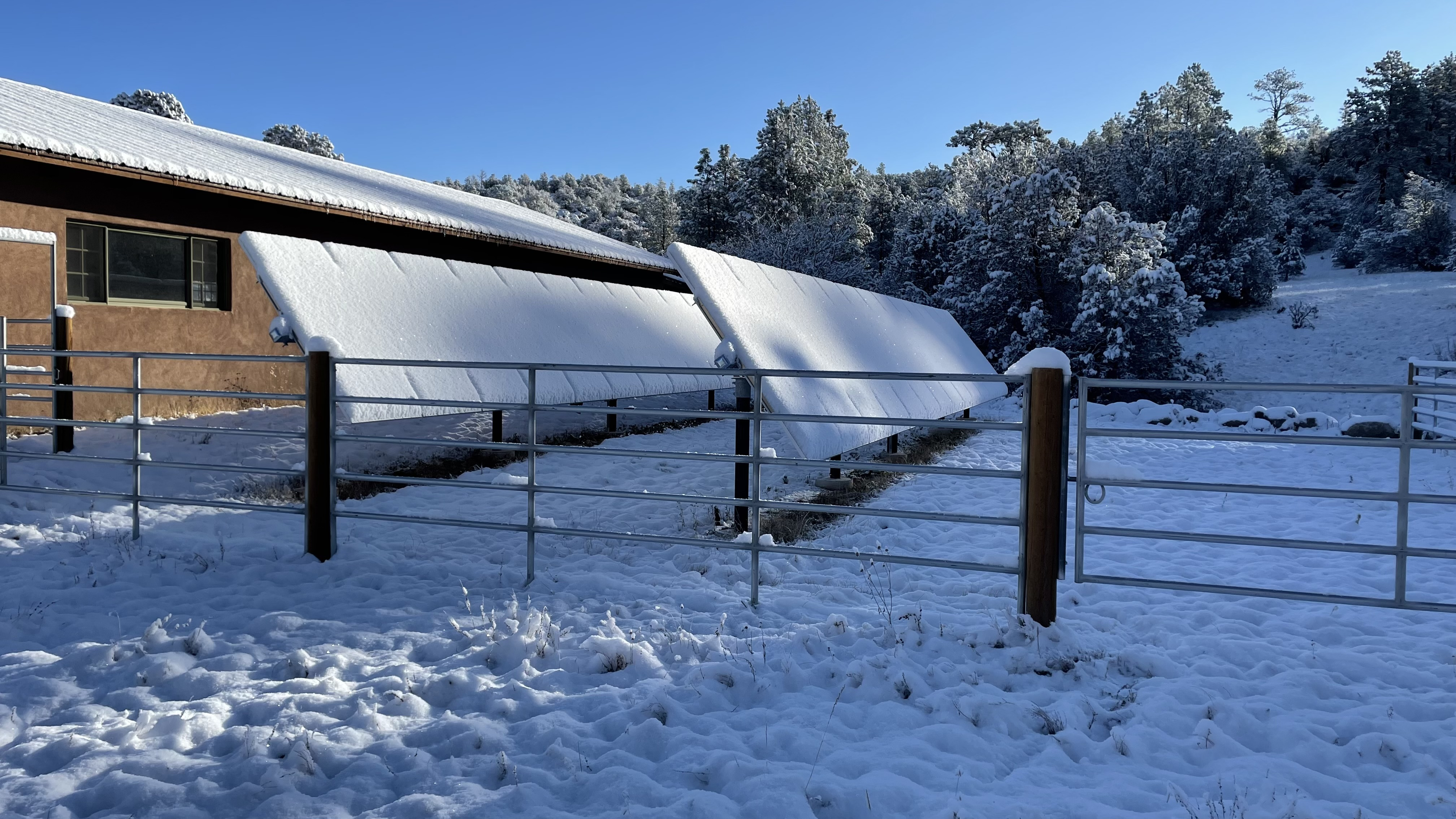

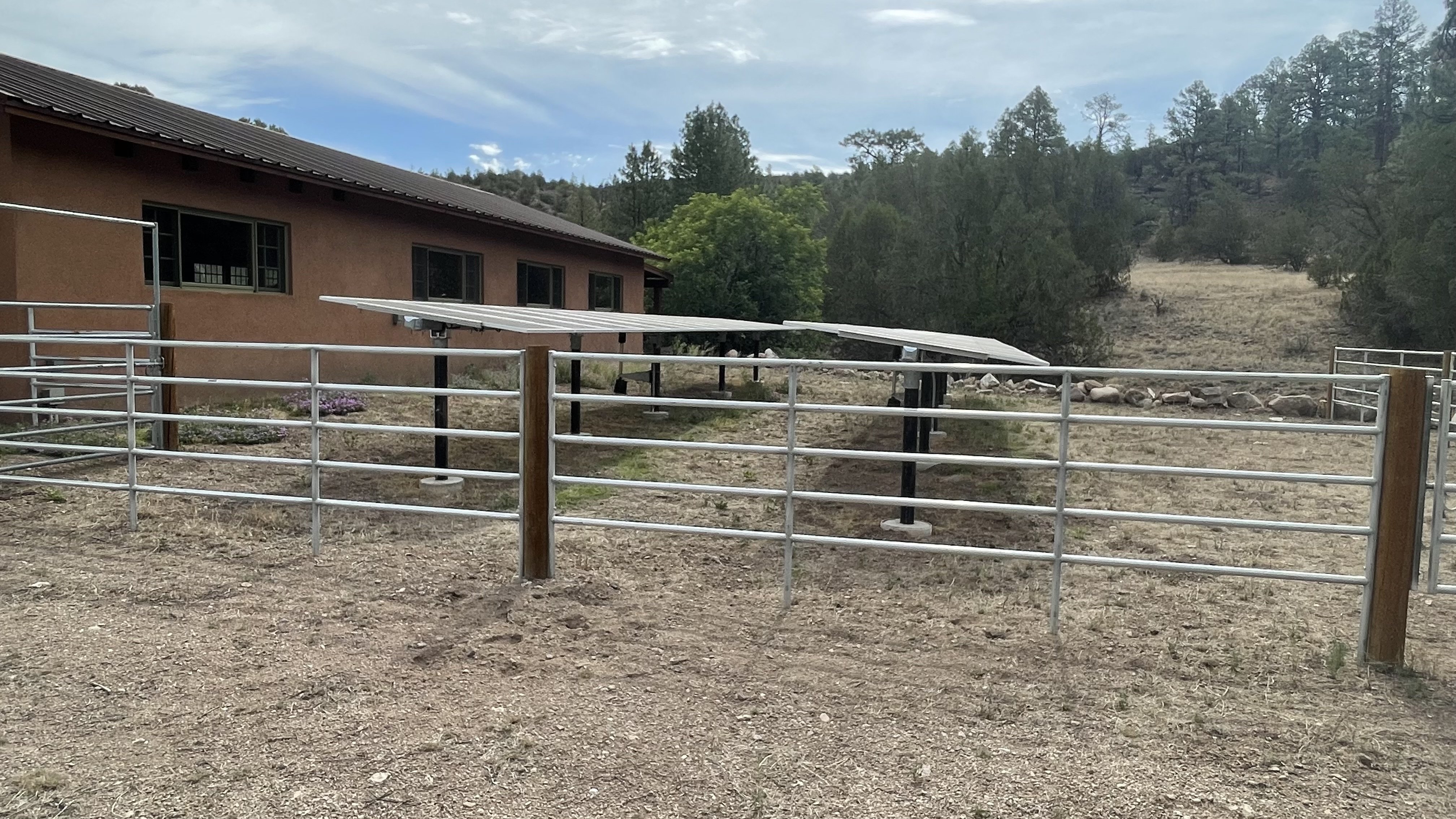

Below the Wattsuns have been tracking for 20 years. 6 inch steel pipes and superstrong frames.
htps://offgridsolar1.com/
E-mail offgridsolar@sti.net -
I reread your comment and saw that. So we're in agreement. :-)I like your choices in rack materials! I like the image, your place is nicer than mine. At least I'm finally getting enough power to handle my basic needs plus a little.Sol-Ark 12, 3 Pytes V5 100ah batteries, currently 12 REC 420w panels installed.
Another vote for Wattsun.
Is that July at the Miller ranch?
Haha, no. I live in South West New Mexico. This is how things look now.
