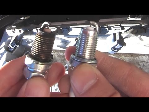

Marketing hype at its finest, Ford has used every slogan and gimmick to premote it's lackluster products, 100 000 mile spark plug replacement! ?........if you have the time to dismantle half the engine to get at them and hope the spark plugs don't break whilst trying to remove them resulting in possible cylinder head removal. Wouldn't this directly translate to any other claims? Blow smoke up someone else's ass Ford.. ...an opinion1500W, 6× Schutten 250W Poly panels , Schneider MPPT 60 150 CC, Schneider SW 2524 inverter, 400Ah LFP 24V nominal battery with Battery Bodyguard BMS

Laser cut platinum plugs have long had a 100,000 mile service life. Honda and many others have done this for at least 15 years. Ford is a great company but this truck will not get them into the offgrid power system market. No offense to the OP, Good Luck!"we go where power lines don't" Sierra Nevada mountain area

The issue isn't with with the spark plugs being able to endure 100K miles in general, it's the particular 2 piece Motorcraft plugs used by Ford, which were known to break when removed, leaving the threaded section in the head, this is common in the 3 valve Triton engine. The use of better plugs such as NGK would probably have made this a non issue but likely cost more, even $1 per unit would result in millions over the entire production run.
Access to the plugs themselves is a nightmare which is probably the rationale behind the use of 100K mile plugs in the first place, so, the burden is placed on the end user when the warranty expires.1500W, 6× Schutten 250W Poly panels , Schneider MPPT 60 150 CC, Schneider SW 2524 inverter, 400Ah LFP 24V nominal battery with Battery Bodyguard BMS

The Spark Plug issue was resolved by 2008, so if you are comparing vehicles of that era, they all had issues.
Funny thing is, I was still selling GM's in 2003, and actually seen an Ad in a Mag about that Spark Plug and Ford bragging about it. It looked very different, long, thin 9/16" Plug Wrench!.
