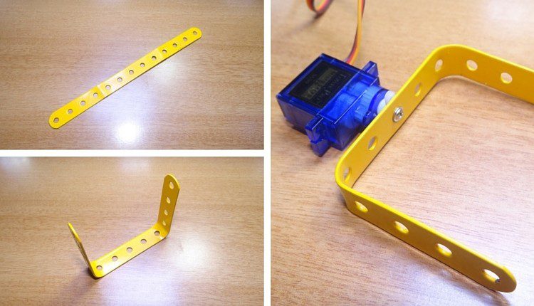

Step 6
- Now connect a servo motor to the Perforated metal strip using Screw.
- Apply glue to the servo to fix it firmly.
Step 7
- Take another straight Perforated metal strip and bend it as shown in the figure.
Step 8
- Now place the set up of solar panel and first servo motor to the metal strip of second servo motor as shown.
