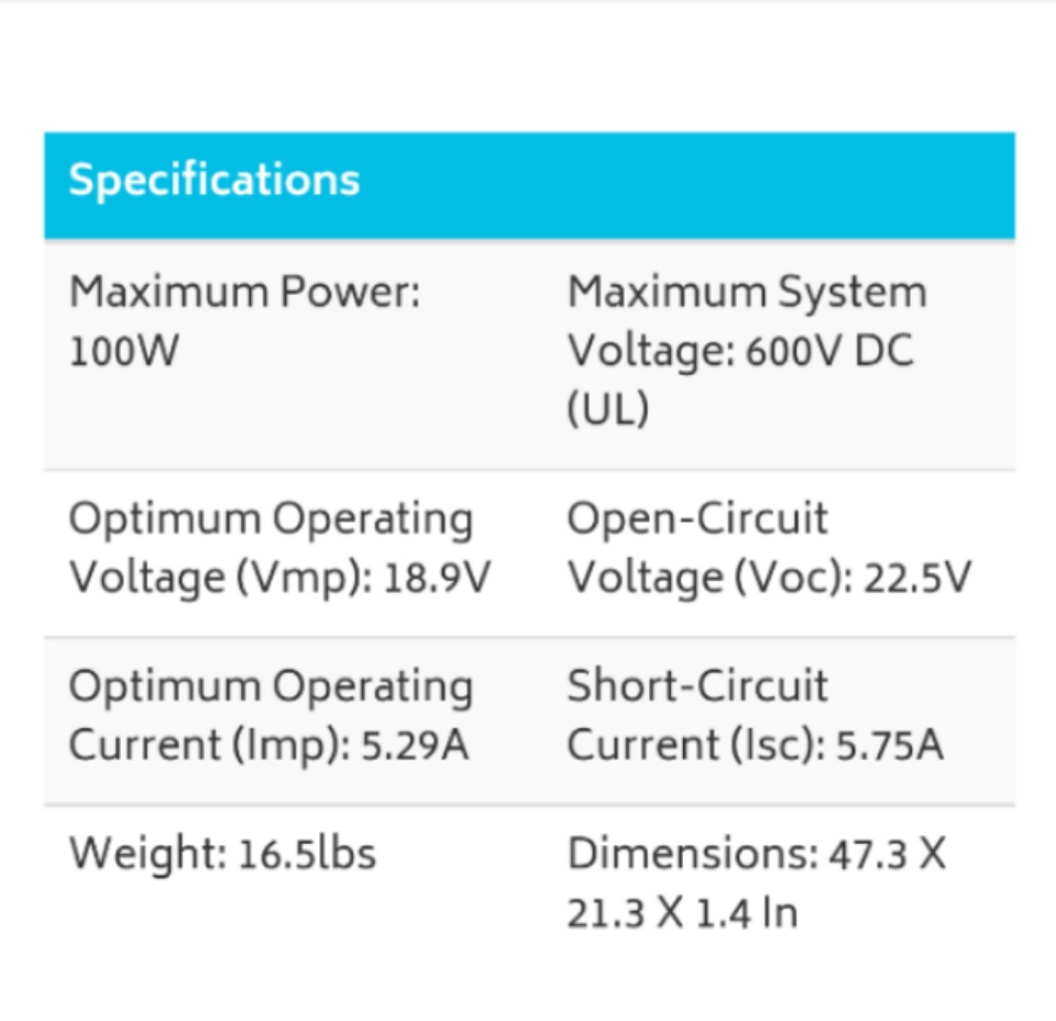

For a small system 400 watts. with a pwm cc. 25 feet to a portable array. Using 2 runs of 8 awg for 2℅ voltage drop. Summer Temperatures are 85f. Which of these panels would be the better choice?

You may want to look up temp coefficients for the lower Vmp panel, and recommended Vabsorb for your batteries. With 2% wire loss drop, and maybe as much as 8-10% temp drop, it may or may not work well. If the adjusted voltage is high enough though, the pwm controller should give more current with the first panel.Off-grid.

@Estragon thanks for the reply that's kinda what I was thinking. 16.4 was to low. Temp co ef and line loss puts me at 15.62 into the cc. found a kinda weirdo 100 watt panel. the picture is not clear but the label states isc is lower than imp. specs 17.9 vmp and 6.24 imp?? 111 watts .Since pwm is amps in amps out im interested in higher amp panels. Seems this one would also be high enough vmp for summer heat.
