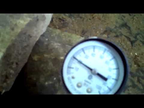

    https://www.youtube.com/watch?v=7O-8FQgxPW8
    watch the part where I talk about static and dynamic pressure....there are several videos of me on that channel, one of them is the local news channel when I first put soalar panels up......I was the only one doing it in this area

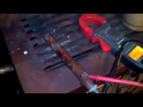

    but the really interesting one is the crystal battery
    https://www.youtube.com/watch?v=PZR7HTXkXC0
    I did some more research on that and found that if you use a magnesium rod and copper, it works a lot better....something about where those 2 metals are on the periodic table of elements and their atomic weight
