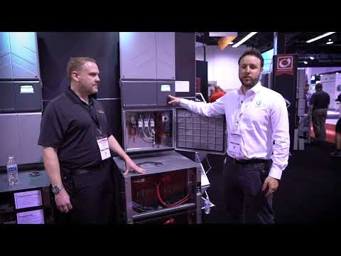

    Just found this video on Youtube.
    https://www.youtube.com/watch?v=8Hbt3FLJVas
