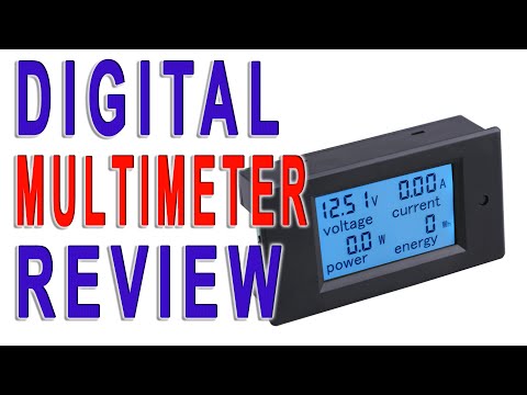

Im using 18/4 awg wire. Im lost on the wiring between inverter, CC and batteries. Any help would help. Thanks!

    Im trying to wire this so i can monitor my solar panels. I couldn't figure where to put it.
  • mcgivor
    Here are the instructions with various configurations, dose this help?
  • BB.
    BB. Super Moderators, Administrators Posts: 33,724 admin
    Do you have a link to the brand/model of component you are using?
    I am guessing this is remote reading volt meter (top and 2nd down are measuring the voltage drop across the shunt--precision power resistor).
    The bottom two connections are - and + power to run the electronics?
    Here is a video that shows how to connect:
    https://www.youtube.com/watch?v=eXF_bR4QUkM
    Hopefully, you have the shunt resistor (something like 100 amps = 0.050 Volt drop across power resistor). The meter does the math to change the 0.0 to 0.05 volt drop to 0-100 amps. And takes volts measured gives the power (Power=Volts*Current).
    Watch polarity, some meters only show "positive" current flow (0 amp on reverse current--Or simply + amps no matter direction of current).
    For connecting to the solar array--As long as Voc (voltage open circuit) is 100 VDC or less, you should be fine.
    In your case the "battery" is the solar array. And the "load" is the Vpanel input for the charge controller.
    -Bill

    Thank you! So in the #1 image for monitoring solar power. I would hook it up to the charge controller on the battery positive and negative not the solar positive and negative. Also would you still say 18awg is too small for thus device. Thanks for the help!

    I was reading reviews for the device and seems many use 20awg so i thought i was stepping up with 18. In regards to wiring it to monitor incoming solar amps/watts ect. It should be hooked up to the battery positive and negative not solar correct. Thanks for the help.
  • Estragon
    It depends on what you're trying to measure. As Bill noted above, the meter measures current across the shunt, so you want to wire it so it gives you the info you want.
    If the meter doesn't show current in both directions, and you want to measure battery current, you will have to decide on whether to measure charging current or discharging current. If the meter shows current in both directions, how you wire it to the battery will determine whether discharging shows as a positive or negative number.
    The wiring of the top two (sense) wires determine what's measured. The bottom two are power to run the meter.

    It would need to be connected to the battery for a stable power source, correct, the monitoring is taken across the shunt resistor.

    I used that same meter in my install - Two of them actually. The wire to the shunt needs to be based on the current running to / from the charge controller, assuming that is what you want to measure. However, the wires to the meter (from the shunt and tapping the voltage) have virtually no current flowing in them, so the small 22 AWG wire is fine for connecting to the meter.

    Hello Please advise :  I have two of these.  The first one is hooked up to a 500 Amp/ 50 Mv  shunt to the battery bank and seems to work fine, however I do not exceed 80 amp load on these at this time.  I was inquiring if these can handle more then 100 amps on a 24 bolt system ?   Also the second one I will be hooking up to regulate the charge from the solar panels, as noted in the configuration # 1, just to clarify this will be connected off the "CC " line to the battery box (Xantrax 60 pwm) and not from the disconnect to the CC?  Would it make a difference ?
  • Estragon
    If I understand the question properly, it depends what you want to measure. Putting a shunt on the controller to battery wire will let you measure charge controller output. Putting a shunt on the combiner to controller pv input will let you measure pv output / controller input current.
