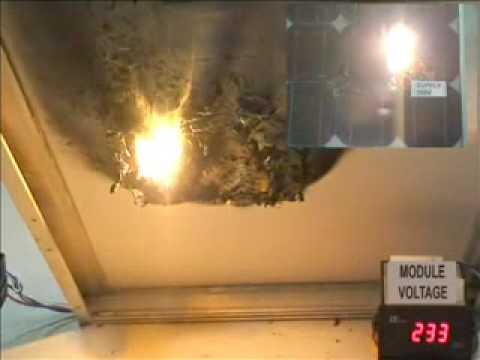

    Solar panel "arc failure" test:
    https://www.youtube.com/watch?v=hyx8gh-tUOM

    In general, anything over 12 volts and a couple of amps is not considered "touch safe" by UL/NRTLs. And anything over 60 volts is only to be accessed by trained personal (locked cabinets/doors) and never safe to touch (interestingly, they do not specify AC or DC or Both). And is a 48 VDC battery bank charging/equalizing at 62 VDC a hazardous voltage or not.
    More or less, any voltage that can drive > 5 mAmps through your body (i.e., heart) is dangerous. And over ~10-t15+ mAmps can be fatal (stop your heart).

    What happens when a solar panel shorts? You basically design the wiring to support Isc of the panel (or 1.25x Isc). That way, if there is a short, none of the wiring will overheat and cause a fire. However, if the failure is an intermittent connection (arcing), no breaker will stop that.
