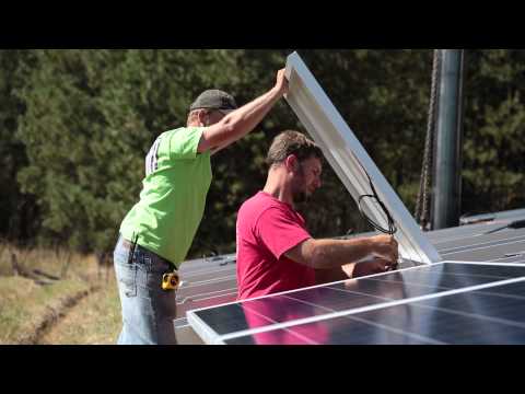

I take it it's a pole mount with tracking? Think about how you will access and mount the panels, Scaffolding, if it's a tracking setup and you can set to level to ground, and even a bucket if you will have a single plane. A ladder would just be frustrating.
I suspect Dave could ad some advice here.Home system 4000 watt (Evergreen) array standing, with 2 Midnite Classic Lites, Midnite E-panel, Magnum MS4024, Prosine 1800(now backup) and Exeltech 1100(former backup...lol), 660 ah 24v Forklift battery(now 10 years old). Off grid for 20 years (if I include 8 months on a bicycle).
- Assorted other systems, pieces and to many panels in the closet to not do more projects. -
It is an MT Solar pole mount. Hopefully the install is as easy as their videos LOL. You assemble the panels on the ground and then hoist it all to the top of the pole and lock it down. No tracking. It has a hand crank tilt adjustment (from 5 degrees to 90 degrees) for the summer and winter angles. Only thing you need a ladder for is to install the last panel. Like I said, SOUNDS easy......

Wbuffetjr1 said:It is an MT Solar pole mount. Hopefully the install is as easy as their videos LOL. You assemble the panels on the ground and then hoist it all to the top of the pole and lock it down. No tracking. It has a hand crank tilt adjustment (from 5 degrees to 90 degrees) for the summer and winter angles. Only thing you need a ladder for is to install the last panel. Like I said, SOUNDS easy......
gen: http://tinyurl.com/LMR-Lister , -
Mike,
In the MT Solar videos they show leaving out the center panel in the array, using a chain hoist to raise it into position, lock it into position and then use a ladder to install the last panel in the center. I have a chain hoist and was planning on doing it just like they show. Are you saying it is not as easy as they make it look? -
Thanks Photo. That's why I went with them. I felt like I definitely needed to be able to adjust the tilt for the winter up there PLUS I didn't want to have to get equipment involved to raise it.
