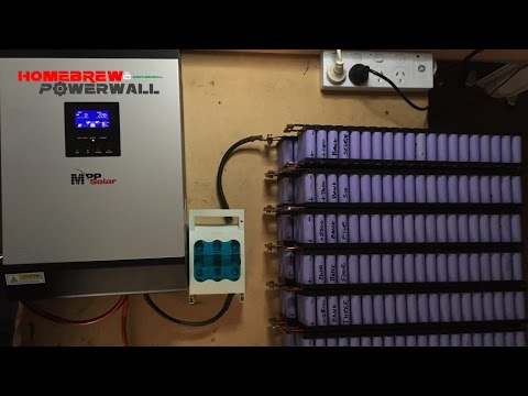

Hello gents, new to the forum, been searching for a place to find some smarter individuals on this matter.
I'll start here. I'm building a home PV system. Iv'e made my own solar panels, and since grid tie is very difficult thanks to WE energies, i'm forced to use a battery storage system. Iv'e looked all around at different types of batteries and landed on LifePO4. They are safe, have a high energy density, can discharge pretty deep, i read 80%. Also the cycle life should be a lot better than LA. Specifics on goals below.
So here it is, i have 160 3.2v 5500mAh lifePO4 cylindrical cells for a grand total of around 2.8kWh of lithium cell. Not bad for $300. My goals are to create a pack, power a 24/7 draw, whilst charging the pack on a 6 hour cycle through the day with the solar. Questions on solar i can pass along to my solar buddies, what i really need help with is the charging system/battery management system, and the overall design of the pack.
Battery ????'s
1)With 160 cells... do I want to parallel as many as I can, and series those parallel lines to achieve my desired voltage?
i.e. Wire 4 rows of 40 parallel cells to achieve 3.2v@ 220 amps, and then series those 4 chains to attain 12.8v @ 220amps?
2) Choosing a voltage. Since i make my own panels.... voltage is not really any special requirement. I don't need a 12.8v system. It could be a 24v or 48v system. I would assume higher voltages are just better for power transmission... but the transmission distance to my AC inverter is only going to be a few feet anyways. Although using life batteries... I can see finding a charge controller that can balance charge 16 cells might be tricky. More or less i need help verifying my thought process on this.
3)Balance charging
Is it necessary with LifePO4? I see some say its absolutely critical... and others who say Life can balance itself much like Lead acid due to its larger than Lipo overcharge tolerance.
4)Balance charging with MPPT. Do MPPT chargers have this ability? Would it be desirable? Otherwise on the charging front i see hobby chargers work very well. Its just a hobby charger wouldn't work with a solar application. I need some form of MPPT that knows how many cells i have much like a hobby charger, and with the abilitiy to balance those cells.
5)BMS iv'e heard good and bad things about BMS's. Some have fried and destroyed packs. Others have prolonged battery life to 5 years. My question here is; would the answer to my solution be to run a standard 'off the shelf' MPPT to a BMS that manages the cells? I feel that's where i'm headed.
6)BMS/MPPT charger ratings.
When i see a battery management system with an amperage rating, is that rating intended to be above the value of the battery? Or is it more or less the max discharge/charge rate? Same question on MPPT's. I assume the latter and more specifically it would pertain to the max charge rate of the battery or the max drain rate, which my load will depend on as well.
That's all i can think of for now! Any help super appreciated guys!

  • PNjunction
    PNjunction Solar Expert Posts: 762 ✭✭✭
    edited December 2016 #8
    Hanslada - a few problems:
    Forget the chemistry right now - this is the "ready, fire, aim" concept, which we don't follow here.  That is, just cobbling stuff together, and throwing it at the wall to see what sticks.
    Before you even begin, you have to know what your *actual* daily power needs are upfront.  In addition, you need to know your solar-insolation hours, (which are vastly different than just sunrise-to-sunset hours), based on your geographical location and calculated for winter months.
    But worst of all, the example in that pic, while using 3.7v dumpster-dive componentry, (and not what we presume is new quality LiFeP04 in your case) is NOT the example you should follow.  Note that some of the builders that do this, basically give the finger to *even their own community* when questions about safety and sanity are raised.
    Basically, you won't get any support for stuff like that here.
    That being said, cobbling together 160 cells, even if they are perfect, is not the way to go.  For a housebank system, currently any LFP system is done with large prismatics (GBS, CALB, Winston etc) - NEW I might add - with the ideal of keeping your cell count low so you choose the highest capacity cells available according to your measured power needs.
    If you just wing-it, especially with LFP, that will be an expensive lesson in not getting out the calculator, and throwing your wallet down the drain.  Unless of course, your objective is to use garbage cells.
    Can I even ask what exactly ARE your cells, and are they new?  Are you sure they aren't counterfeit / rewraps / used cells.  26650's, or 32650's?  At any rate, for a serious solar housebank, that is out of the question anyway. :)
    This isn't going to be cheap, and trying to cheap-out with hundreds of cylindrical cells just shows that you are willing to cut corners in both safety and eventual performance.  LFP aint cheap upfront so forget about trying to cut corners with hobbiest-style cockups.
    Ok, so you blew $300.  Perhaps you should get some gear to match them for both capacity and internal resistance, put them in small holders for say a low-capacity 12v battery, and get some practice handling them first.
    Starting out trying to emulate Tesla with hobbiest-grade LFP cells just isn't the way to get off on the right foot.  The catch 22 is that asking technical questions about how to go about it, means that you *desperately* need some real hands-on, and not just forum commentary.

  • hanslanda
    hanslanda Registered Users Posts: 10 ✭✭
    You may want to re-read my post. Most of the questions you asked reside within that post. This is a smaller capacity system in which i'm more or less playing with to learn some lessons. It's going to drive a 100 watt hour load or so to start. So far my largest take-away from the information provided is ya'll like the word "cobble". I do mechanical design right now... i won't be cobbling. This is going to be a nice pack, with cell balancing, and the ability to remove/replace cells. All of my cells are 100% new and unused.
    I understand your comfort in LFA or LA but consider this:
    Home storage will go to lithium-ion regardless... Tesla is a huge drive for that. Their new 14kW powerwall is certainly lithium ion. And how does Tesla build lithium ion packs? With a very large quantity of cylindrical Ion cells. Do you know why? Because it doesn't make any sense to have a home power system when you need to purchase 4 grand in lead acid batteries every 5 years. Lithium iron's cycling ability far exceeds LA and that's comparing 1C discharge rates. At a 0.05C discharge do you have any idea how many cycles a life battery with last? Its also flat out safer than li-co or lipo. Lithium iron is already not much more expensive than LFA or LA and when you consider you'll be getting a lot more cycle life.
    This is not the "ready, fire, aim" concept you have described here. I know exactly what i wish to attain as a goal and i know 98% of how i'm going to accomplish that. If this is not clear to you, start asking the correct questions.
    I would like to point out to the uniformed here that Tesla also makes their car batteries out of approximately 7000 18650's. A smaller version of the exact same technology i'm going to be using. If you do not know what a 18650 is.... you do not even belong in this thread...
     If using a high quantity of smaller cells were dangerous i'd be hard pressed to discover why it is currently the industry standard for EV's? You know an EV, that has to go through vigorous DOT safety testing before it can even hit the road...  I'm not saying some of these concerns aren't valid... but they appear to be BROADLY unfounded.
    And Tabby Cat i'd say you must be uninformed or really high. Tesla's powerwall is 14kw for $5000.
    "(24 volts, 2.6 KWH) for $2600 from Torqeedo"   -This is a rip-off   1000$ per kw? Are you kidding?
    Again tesla sells powerwall @ 14kW for $5000.  $357 per kW....................
    Like junction mentioned, the application is not apples to apples. That battery is likely rated to 10C+ regular discharge. A home battery doesn't even need to run 0.5C. High discharge batteries cost more, simple as that.

  • hanslanda
    This is the cell fusing Tesla does off each parallel bar. I intend to do the very same thing. IF a cell goes totally short, or begins to massively drain others in the chain, it will short the fuse, and eliminate itself from the parallel line. The only result is a blown fusible link, which will be observable (noticable to replace), and a lower total amperage capacity on that line, which wont cause any harm to the series battery. Theoretically the cell will never reach dangerous temps (again life doesnt anyways) because current would be cut before it had a chance to go above say 10 amps off one cell.

  • karrak
    karrak Solar Expert Posts: 326 ✭✭✭✭
    edited December 2016 #18
    Yes, this is the way I would do it. I have 8 blocks of 4 90Ah batteries in parallel hooked together in series to make a nominal 24 volt battery, this is known as a 4P8S battery. This method averages out variations in the individual cell capacities and make the battery easier to balance and monitor. One comment, instantaneous power measured in Watts (W) = Voltage x Amps. Energy stored in a battery (Wh) = Voltage x Amps x (hours that the amps have been flowing). This is equivalent to Wh = BatteryVoltage x Ah.
    As well as less transmission losses you also have to consider the fact that the maximum power output from solar charge controllers is limited by the current output. If you have a 20A controller it will be capable of charging at 240W for a 12V battery, 480W for a 24V battery and 960W for a 48V battery.
    3)Balance charging
    LiFePO4 (LFP) batteries cannot balance themselves. Having said that my experience is that they go out of balance very slowly. Over a period of months. As they age they seem to go out of balance at a slower rate. It is very important to balance an LFP battery before you commission it.
    Not to my knowledge, the MPPT controller will only regulate the overall battery voltage. Having said that if your battery is in balance overall battery voltage is all that needs to be regulated. For solar charging I think a very good charging regime is to charge the cells with the bulk voltage set to 3.45V/cell (13.8V for a 12 volt battery) and floating at 3.35V/cell (13.4V for 12V)
    A BMS does a number of functions, some/all of these functions can be done by a human with a multimeter or some/all can be automated. The choice is up to your technical ability, how much you want to automate the process and how user proof you want the battery to be.
    As a bare minimum I would suggest a cell monitor like a Cellog 8 to monitor the individual cell voltages. The Cellog 8 will also generate an alarm and can also be used to stop charging or disconnect loads if any cell goes out of its safe operating voltage range.
    The other important function of a BMS is to keep the battery balanced. This can be done manually by keeping an eye on the individual cell voltages. When they diverge too far when the battery is at the end of charging a simple resistor load can be placed across the cells which are too high to remove some charge from them. If you have automatic balancing I would recommend having cell voltage monitoring as well to tell you if the balancing circuit has failed.
    If you want an intelligent programmable BMS. I haven't tried this one, but on paper I think  http://123smartbms.com/  is the best commercial unit available at the moment.
    The better fully automatic BMS units available will disconnect the battery from the charger and loads in the event that any cells go outside the safe operating region. The components that disconnect the battery have to be rated at a current carrying capacity greater that the current that the solar controller will supply or the load will consume. Limiting the discharge current to 0.5C (half the battery capacity in Ah) and the charge current to 0.2C and keeping the battery balanced should give you longer battery life.
    Simon

  • karrak
    I like the idea of individually fusing each cell. You will have to be careful that all the fusible links are the same length and that the bus bars that they are soldered to have a large enough cross sectional area to carry and balance the current going too/from the individual cells.

    As for home brew, if the person knows what they are doing they might make a product that is better than anything that can be bought because they don't have any marketing constraints like cost, planned obsolescence etc.
    What about the  fun and sense of achievement designing and building ones own equipment.
