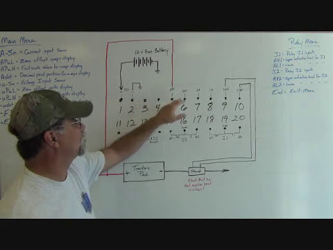

    This is the one I have.
    ECPC404 Ammeter and Voltmeter
    Intelligent Digital EV Battery Pack Monitor
    Amp-Hour Counting
    Check it out here:
    http://www.electriccarpartscompany.com/ECPC404-Ammeter-and-Voltmeter-br-Intelligent-Digital-EV-Battery-Pack-Monitor-br-Amp-Hour-Counting-br-USA-Stock_p_425.html
    This is a video on how to set it up:
    https://www.youtube.com/watch?v=TJcToZoVzbw
    I think it's what you are looking for.

      Hmmm, that does do what I'm looking for at a notably lower cost.
