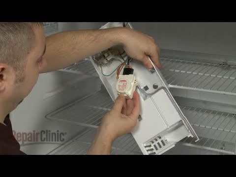

Is there any way to program the defrost cycles to happen during peak solar periods? -
My "cheap" refrigerator/freezers use a cheap timer motor that (appears) to disconnect the compressor and turn on the defrost heater. After ~1 hour, it turns them off... So, I do not see any issues with slapping in your own relay/programmable timer module.
In units I have owned, the timer is usually on the bottom of the fridge (front or rear)... Although, they can be inside too:
That would be a bit more difficult to access.
The new refrigerators with electronic controls (ice maker, cold water, defrost, multizone temperature control, etc.)--I would not attempt to change the defrost timer periods for those. Way too many things to go wrong / debug.
