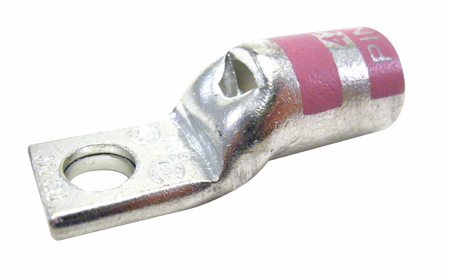

Hello,
I just bought 2 - 4 foot sections of 1/0 Copper cable from the Home Depot and 4 Crimp on lugs.
The guy at home depot said I could use a punch and hammer to crimp them or solder or braze them on.
I do know that the CORRECT way is with a hydraulic crimping tool.
Cheapest one I've seen is at Harbor Freight for $53
Are there places where you can take cable to have the lugs crimped or is there another "good" and "safe"
way to crimp these ends on or do I need to bite the bullet and just buy the HF crimper?
Thx

    I don't think you can crimp it without special tool. I used this inexpensive hammer crimper. It worked very well on 4/0, #3 and #6 wires.
    I don't think soldering is good because if the cable heats up it may melt.

    check out your local welding supply house or automotive supply place that MAKES its own battery cables.

    I take mine to the welding supply and they use a hydraulic crimp tool to do it right.

    However, I assume that the cable from HD is NOT Fine Stranded, which ALL of the Welding cable (that I've seen) is. Fine strand lugs will not work well on THHN type's usual 19 strand wire/cable.
    Some here have mentioned using the HF Crimper. Most of the comments I've seen on that crimper were that it did an OK-to-good job.
    Done making assumptions for now. YMMV,, Good Luck, Vic

    I have the HF crimper. It will crimp up to a 2 gauge terminal. I cannot get a 1/0 terminal into the jaws. It does a good job crimping, though. On the larger cables, I use a Forney 57637 Lug Crimping Tool. It does a great job when using it along with a sledgehammer. The 2-gauge HF inverter cable is fine stranded.

    I bought some ALUMINUM Terminal Lugs from Lowes that fit up to 3/0 cable and have a heavy set screw that tightens down on the cable.
    Are these ok to use or is Aluminum for lugs a no go ? (I can still return them).

    Do not use the aluminium lugs. Copper & aluminium do not get along without some special handling. Even aluminium on its own needs special anti-corrosive measures. These things are meant for connecting heavy aluminium wire such as is used with utility feeds.

    My personal opinion, I would not use Aluminum lugs unless it was for temporary use. There have been just too many problems with aluminum connections over time (excluding the use of aluminum wire with properly rated and installed aluminum crimp type connectors as used on utility lines and heavy aluminum cabling).
    If you must use something like these, then make sure you use the proper sealant (grease) with this lugs.
    Copper versions are ~$5.40 vs $3.30 for aluminum:
    Attachment not found.
    I would use the copper.

    Ok, stay with Copper Lugs.
    I couldn't find COPPER lugs with a screw like the aluminum lug for any wire larger than 2 AWG.
    Nothing for cable bigger than that and definitely not for 1/0, 2/0, 3/0 or 4/0
    Does anyone know where they can be found (not Home Depot or Lowes, I checked).

    What about these....They are made of copper, for copper cable only)
    6MFV7_AS01?$productdetail$
    And this Lincoln Electric Cable Crimper to crimp it?

    I crimped some 1/0 copper from HD and used that same lug (from HD) yesterday-> it worked fine. I used the HF hydraulic crimper (bought using a 25% discount coupon) and I used the 0 gauge die. To get the die to fit I placed the barrel of the lug in the die, powered down until it would hold the barrel in placed (I centered the contact section of the die to center strip on the lug), placed the wire into the barrel opening, and started compression, a little slow as the lug is pretty thick. On 2 of the 4 lugs, I compressed a little, then loosened up and rotated the barrel so more of the barrel was being compressed, so as to not leave one section as uncompressed. I decided that the one-pass method produced the same lug compression so I finsihed that way. The compressed lug was too large to exit the die when complete.....until I threaded it out by moving the lug out from the barrel (wire) end to the lug attachment end.
    I've used that HF crimper for MC4 connection, #8, #4, #2 lugs and I really like it. I'm going to try to fabricate/rig some metal pieces to let it be used as a mini hydraulic punch/press .

    T&B makes compression terminals of various sizes in copper. These are available at Home Depot. Obviously, the larger the size, the higher the cost. I've used these on the battery cables for years. Be sure to torque the set screw to the recommended value. FWIW, that was a LOT tighter than I felt comfortable turning the screw. Thought it might strip, but none did, and none have ever loosened.

    Brazing and soldering are similar processes. Brazing involves higher heat and different flow material. The application of higher heat and the stiffer brazing rod material would exacerbate the potential problems encountered with soldering.
    A couple of us here have found the best method is crimp, solder, sleeve (with heat-shrink tubing). This does not work well with larger size wiring because of the difficulty of getting the solder to flow (heat is dissipated quickly). The contention that this process presents trouble from a wire-flexing point of view has to be mitigated by the fact it is not normal for battery wires to move anyway.

    DONT BRAZE THE WIRE INTO THE LUGS. It does really bad things to the properties of the wire. We did this experiment on various sized wires at work a long time ago. The results were a disaster. We were looking for a way to overcome the problem most people dont have a hydraulic lug press for wire thicker than #0.
    THE ONLY way to connect lugs onto wire above #0 is with a hydraulic press. Other methods will give varying rates of success but will NEVERequal the hydraulic press method.
    Soldering afterwards is a good idea as it stops corrosion between the lug and the wire strands. It will lengthen the useful life of the cable by years. use a gas torch like what plumbers use and do the heating as quickly as possible. Overheating the lug is not good it changes its conductivity. This has been proven by us at work..

    Yes overheating for a long time has an effect on the surface of the copper. It really does increase its resistance.. I cant at the momenent find the test figures,but when I do will post them.
    I did a lot of testing and gave most results on the forum of using copper pipe for lug terminals.mabe someone can find it or you can and read the results.
    Soldering by itself is useless on cables above #10.They MUST be crimped first.
    Do NOT pre tin the wire or the lug before crimping. Not today not tomorrow .not ever
    Lug presses that depend on you using a hammer.mallet,200lb rock are NOT totally successful. When you strike the lug/wire it has a small amount of "springiness"that reduces the "tightness" of the connection. Yes I know many people say it works great for them, and to a fair degree it does but its an 8 out of 10 compared to 10 out of 10 for using a hydraulic crimper.
