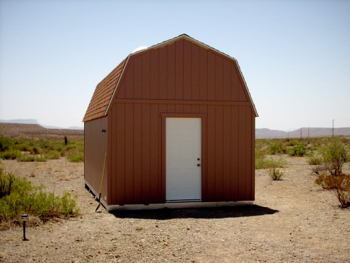

This is THE PLAN as carved into my little brain at 41.. This wil be a 24v system.. (using pairs of 12v panels.. 17.X+)
I am 7 miles from a real road.. no power to my cabin.. 22 miles from a town.. in S.W. Texas..

I will be adding about 14 110AC outlets inside the cabin and another small breaker panel to link this to that..
I will be running either a 24vdc Shurflo or the 110v model (which is .9amp max draw).. it will be switched..

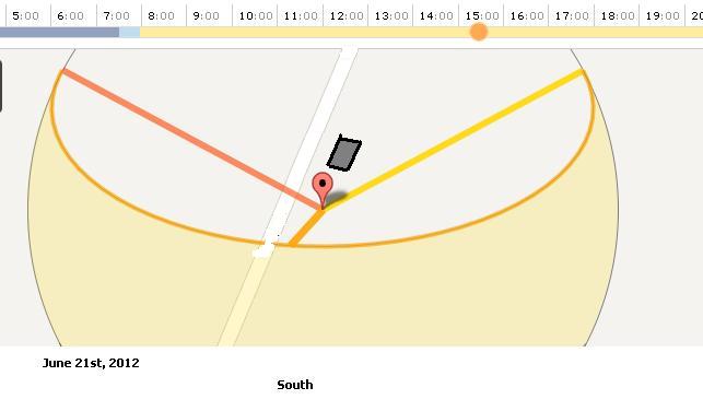

    I am lost by the comment on no sun.. 780 watts of panel aiming almost due south at time of usage for the MAX of 2 hours of A/C running..
    Plenty of sunlight from 11 am to 5 pm facing south.. and no trees in the way. Panels will also be facing south at rear of cabin..
    Even at 52% numbers the panels will be cranking about 400 watts per hour a that time frame..
