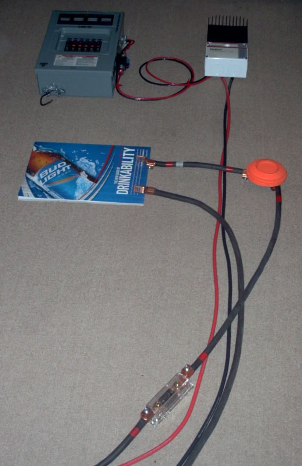

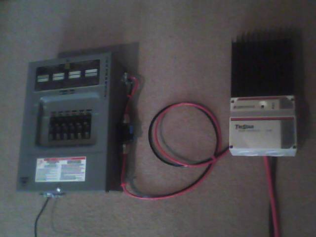

 Got the 60 amp breaker wired in & mounted to the outside of the combiner box..
 the Morningstar TS-45 (PWM) is due Monday and so is the 250 amp ANL fuse/block..
            Re: Final plans for 24v system.. ready to order..
 Update.. got the MorningStar TS-45 (PWM) controller..
 Heres an overall shot.. (the CLAY is the Bluesea Battery Switch on order..)

 Update #2... the BlueSea Battery Swich has come in.. $21 on EB.. and I went to autozone and grabbed some marine terminal adaptors $4 just in case I ever need to use a regular 12v car battery in a bind (has the wingnuts).. I also went to HDepot and grabbed another pack of the mechanical lugs to the end of the wires at the battery end and some 6AWG 3/8" ring terminals for the wire that comes down from the charge controller.. the 60 AMP breaker for the controller to battery should be in by Saturday.. I won't post any more pics till I get the 2000w inverter..
 I hope this helps others who may think diving in is the best route.. (it is not and take your time to figure before you start buying ANYTHING..)

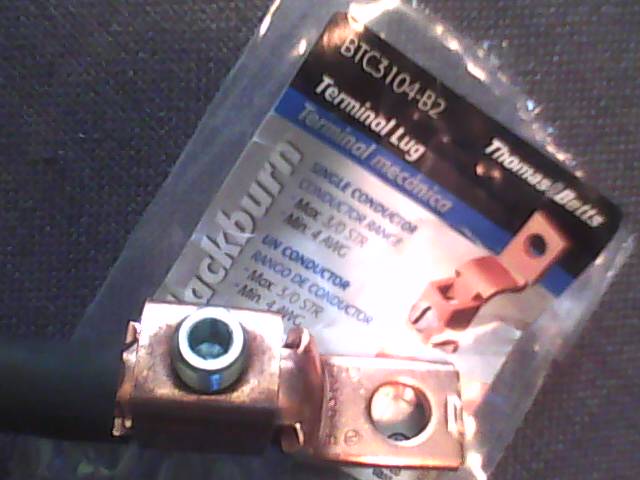

            Re: Final plans for 24v system.. ready to order..Found some 3/0 - 4 AWG mechanical lugs at Home Depot.. $4.49 for 2..
 BlackBurn / Thomas & Betts BTC3104-B2.. HD SKU# 526747.
 Bought 3 packs so I can do my inverter leads, fuse, and battery switch..
 Note.. the wire was actually 3/00 (measured the bare wire diameter).. still FREE is good..
 Heres one lug installed.. :cool:
 i like those lugs, how big are the holes for the mounts, 3/8"? i looked at the spec sheet on homedepot.com and it doesn't listit...
            Re: Final plans for 24v system.. ready to order..i like those lugs, how big are the holes for the mounts, 3/8"? i looked at the spec sheet on homedepot.com and it doesn't listit...
 Yup.. 3/8" works good for most battery and inverters..
