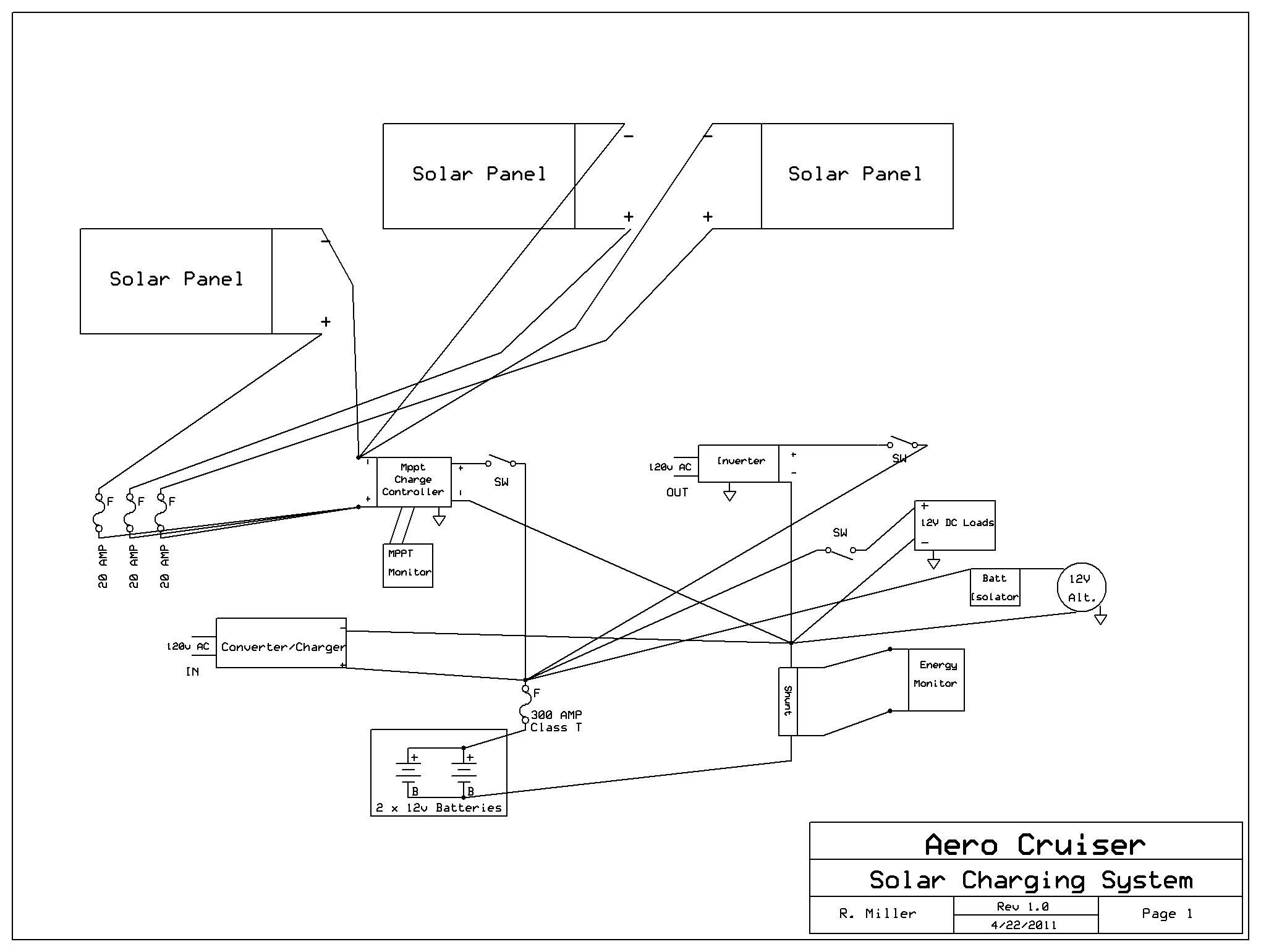

  • Wanderman
    Wanderman Solar Expert Posts: 180 ✭✭✭
    Re: Balanced MPPT system?
    Cariboo,

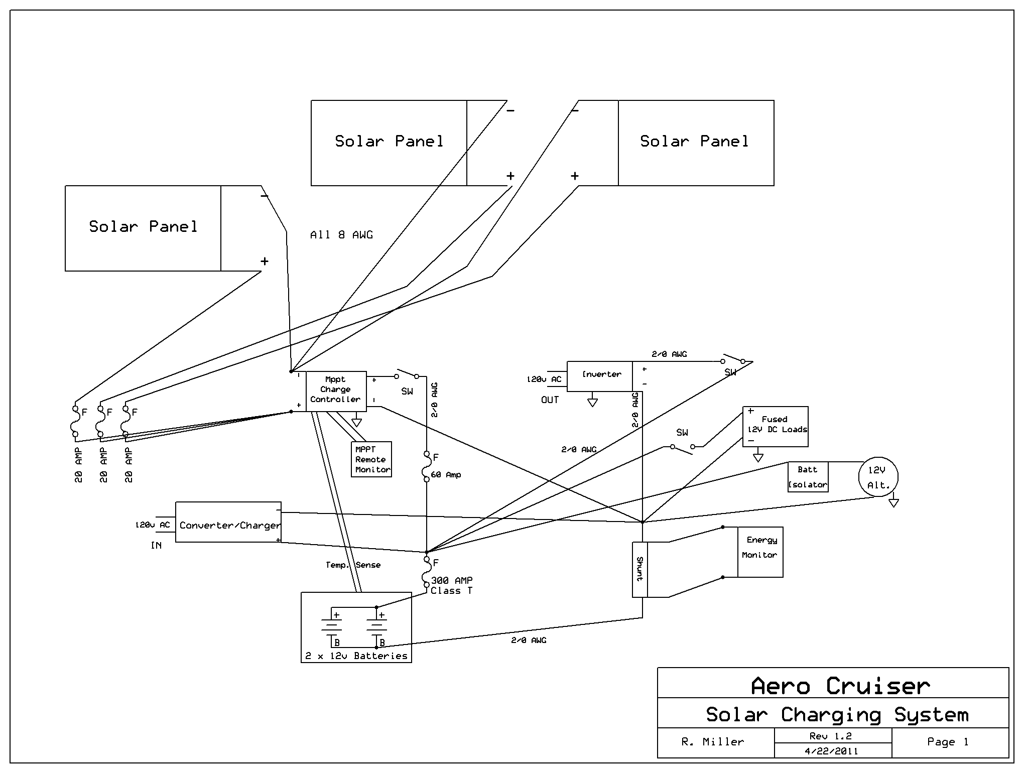

    Yes, Clear as mud! The wire sizes are larger than is required so should be OK, the change will allow a 4 foot decrease in wire length from the solar charger to the battery positive. Essentially the 2 AWG cables OUT from the solar charger go to the terminal studs of the inverter which already have 2/0 heavy cable going from them to the battery (and shunt) This way I do not need to run additional cable from the solar charger all the way to the battery (and shunt)
    I know this diagram isn't drawn all that well, but this is the system layout.
    This shows the extra wiring..simply take the POSITIVE AND NEGATIVE from the MPPT controller and go to the INVERTER terminal posts. Then on to the battery and shunt.
    It just didn't seem logical. Pull 150 AMPS into the inverter and the 2AWG lines connected to the charger get energized with that current as well....? Odd, I just do not want to blow any of the expensive bits up!

  • Cariboocoot
    Maybe you omitted for clarity, but it appears you are relying on one fuse at the battery to handle all loads and incoming charge power. That is a definite no-no.
    To be fully safe, you need to arrange it so ever circuit has its own, separate protection. The charge controller to the batteries is a different circuit than the batteries to the inverter, no matter how the wires are laid out. The same for the converter/charger and the 12 Volt loads and the alternator. The reason being that what would be an overload for one circuit would not necessarily be an overload for another. That inverter could draw hundreds of Amps and is fused for such. The charge controller will not produce that kind of current, so a 300 Amp fuse is no fuse at all to it.
  • Wanderman
    Cariboocoot,
    I realized I pasted the older version of the diagram....D'oh!
    Here is the correct one:
    You'll notice extra 60AMP fuse and a few other mods. The 60AMP fuse in the new iteration would be BEFORE the 2AWG line reached the POSITIVE terminal of the INVERTER.

  • Cariboocoot
    That's better, but ...
    You're still relying on the 300 Amp fuse for everything else?
    Let's look at it this way: you'd normally have: battery post, a short conductor, the 300T, then a long conductor to the inverter. The charge controller would have its own fuse before connecting to the battery post. The battery post is the common point.
    What you're doing is moving the common point. So you need to rearrange a few other things. Now you have: battery post, long conductor,* the 300T, then short conductor to the inverter. Now the common point is at '*'. The long conductor is an extension of the battery post.
    And the other devices must follow suit, whether they attach at the battery post directly or at the extended common point '*'. As in: converter-charger, fuse, common point. Remember different devices have different current level potentials and thus different size wiring. You need the right size fuses to protect that wiring. A length of 10 AWG from the alternator will fry long before that 300T pops.
  • Wanderman
    Cariboocoot,
    OK..I see what you mean. Each of the other lines to the 300 AMP T class fuse actually has a fuse within the "box" I simplified the diagram when it came to existing components. So, e.g. the CONVERTER/CHARGER has it's own main fuse on the POSITIVE terminal. And the box marked FUSED DC Loads is just a large DC distribution point with multiple lines and fuses at each.
    Though, it looks like I will have to move the positive lead from the Solar MPPT to the BATTERY side of the INVERTER switch. I usually leave the inverter switch OFF and I would like to have the hard-won solar power actually Reach the battery bank!

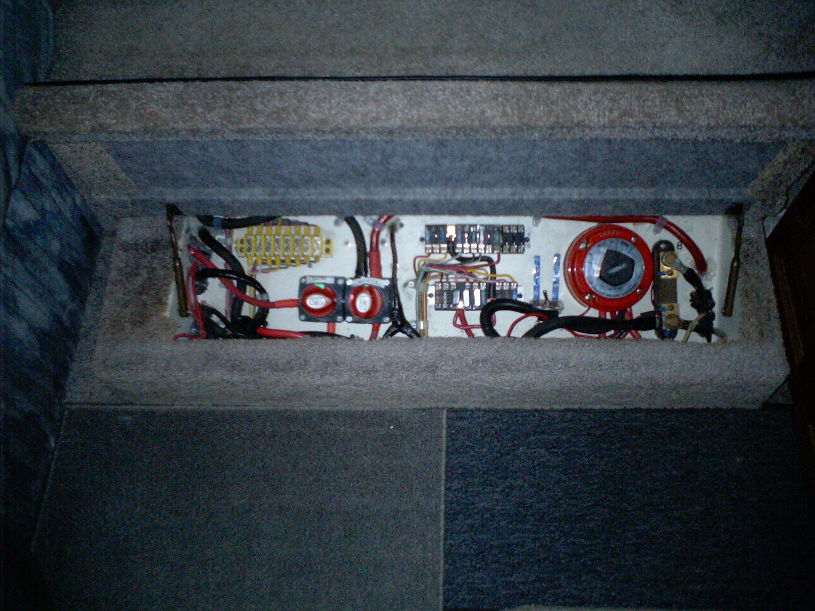

  • Wanderman
    Just a quick picture of the new electrical box. This contains all the switches for the batteries, inverter and solar controller. The switch for the panels is located near the fuses for the panels on a wall by the cables from the roof.
    More as I take them.
    Still have to touch up a few edges and corners of the flat panels with 3M 760 and fill some holes with silicone.
    Almost done!

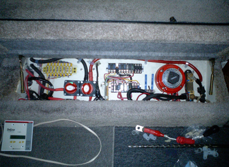

  • Wanderman
    A couple of later pics.
    I'll get some on the roof after the 3M 760 dries and I silicone seal the wiring.
    Thanks for everyones assistance, I could not have done this properly without your help!

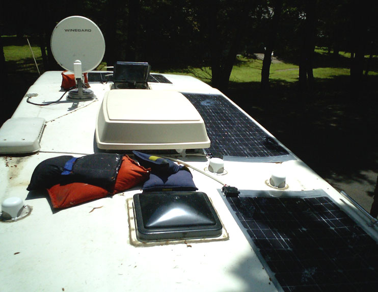

    Been working on various things today so I took a photo of my small roof. If anyone recalls that what started this hunt in the first place.
    All that's left to do on the roof is adhere one more feed line down to the roof, paint the junction boxes white and run a bead of silicone around each panel for security and erosion protection.
    There is an odd reflection in the right side front panel...looks broken, it isn't ;)
    Almost there!
    Thanks to all who helped, especially on this forum
    Rick

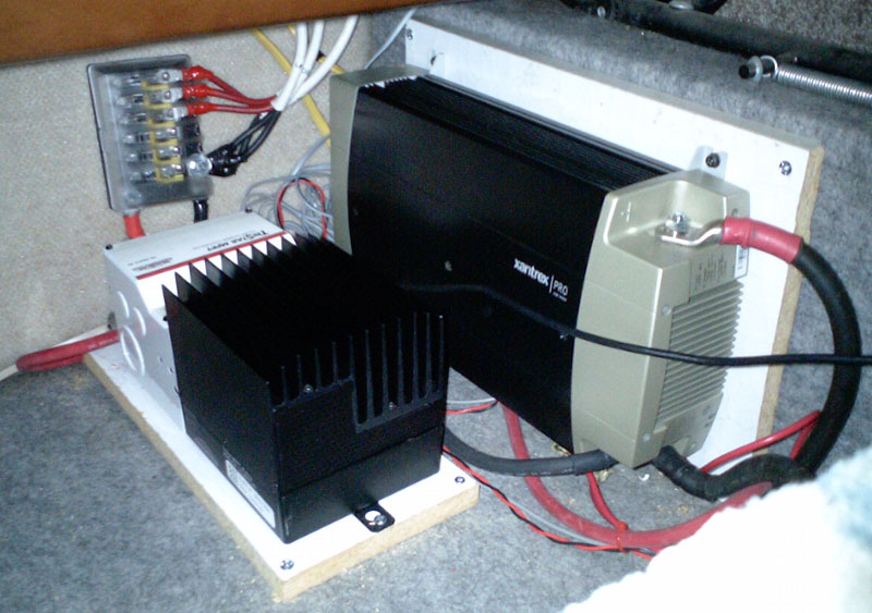

    OK.
    Just finished most of the finishing on the inside components of the install.
    Here is a photo of the Morningstar TS-45-MPPT controller, the Xantrex 1800 Watt Inverter/transfer switch and the wiring and fuse panel for the panels.
    I haven't been doing run down tests yet, but without shore power I have seen 250Watts and 17.8 Amps (I have 450 Watts of ~36V panels) This was after turning on everything I could think of except the inverter.
