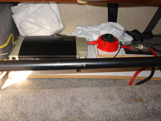

OK...the Charge Controller and remote have arrived! I am remeasuring the wire runs to make sure I am buying enough duplex cable for the install.
Have a new issue.
Looks like the inverter was/is wired directly from the batteries with separate positive and negative cables (2/0) The negative wire does NOT go through the monitoring shunt.
Simple solution? Can I just cut the negative 2/0 cable and (with proper ends) wire the one from the battery into the shunt then from the other side of the shunt directly to the inverter negative terminal??
Is there an easier way?
The cables that run from the battery to the shunt for the rest of the 12v loads appears to be 2AWG, which is fine for nominal 12v loads it carries.
What do you all think?? Pictures and additional info below:
Rick
Inverter install (will be changed to compact the amount of space. The negative terminal and cable is hidden behind the horizontal pipe. The cable goes from the inverter negative directly to the battery bank negative terminal.
View of the Shunt and selector switch. Negative cables run from shunt out and underneath the floor. I would attach the 2/0 terminal here run left to inverter. Attach other side of shunt run out and underneath to the negative battery terminal. I am concerned the existing negative is insufficient for the inverter load. -
Re: Balanced MPPT system?
If you want the battery monitor to measure everything going in to or out of the batteries (proper install) the shunt must be in line with all connections. That is: Battery (-) - SHUNT - Everything else. As was, it apparently would only monitor current going in so you'd have no idea of the state of charge.
You're right about the wire too: has to be heavy enough to handle the max current. In this case the inverter load. The charge output is tiny compared to the potential of a fully loaded inverter. -

I've FINALLY Started the install!!
First nice day on a weekend in months and I've begun to install the system.
So far, I have removed, compacted and re-installed the AC side of the Inverter. All new AC Romex wire runs to the new location. (Lots of space rescued from the previous install)
Begin removal of the direct wired positive and negative 2/0 leads from inverter to battery (bypassed the Shunt...not anymore!)
Tomorrow, weather permitting I will run the new (much shorter) 2/0 leads from the battery positive through the disconnect switch and catastrophe fuse to the positive battery terminal and the new negative through the shunt.
Question:
Should I take positive from the same terminal as the rest of the system, or isolate it on the opposite battery positive terminal (currently I have the two older Trojan 27TMX batteries still in and will not switch until everything is finished.)?
Thanks....
Rick
