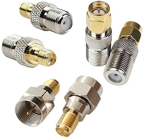

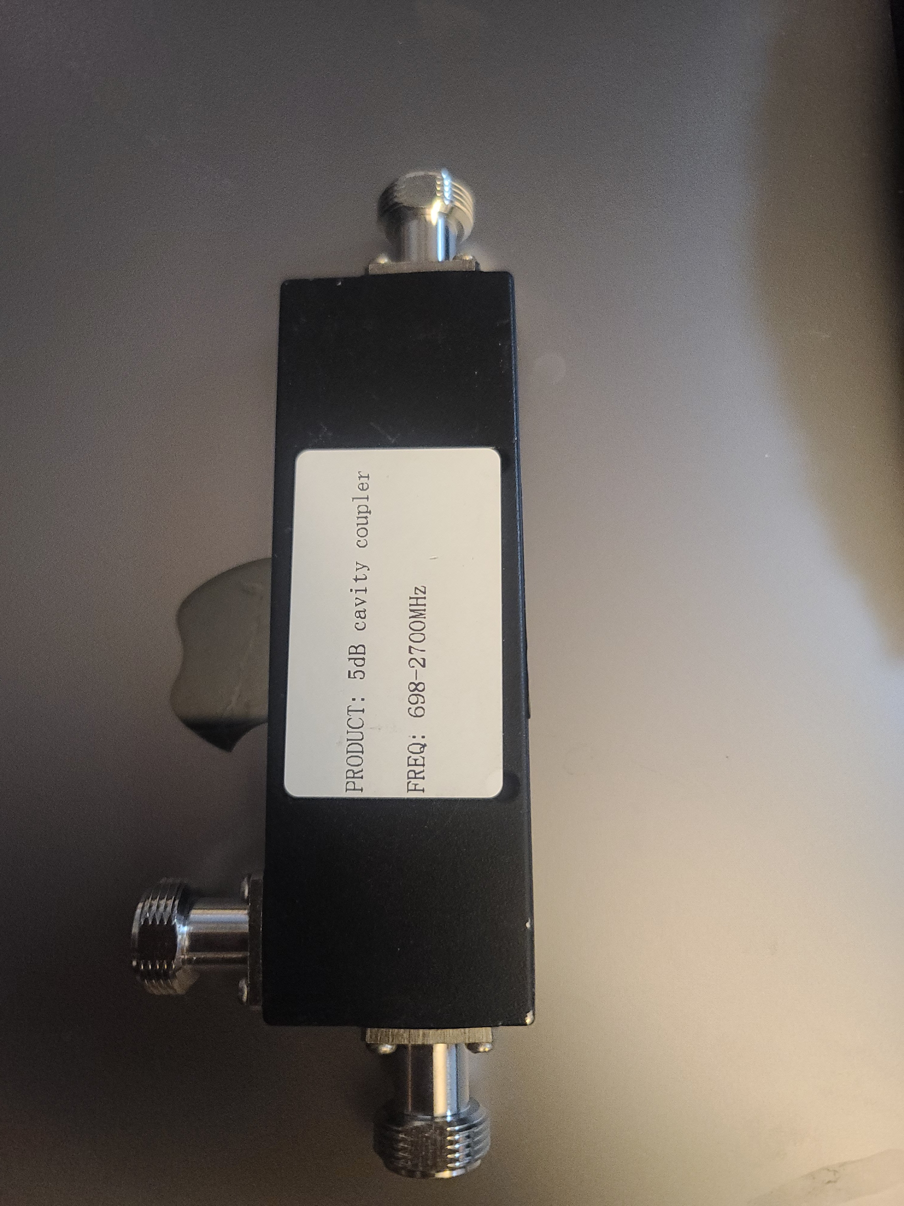

C
Clearly two inputs and one output.
But which function as inputs?First Bank:16 180 watt Grape Solar with FM80 controller and 3648 Inverter....Fullriver 8D AGM solar batteries. Second Bank/MacGyver Special: 10 165(?) watt BP Solar with Renogy MPPT 40A controller/ and Xantrex C-35 PWM controller/ and Morningstar PWM controller...Cotek 24V PSW inverter....forklift and diesel locomotive batteries -
Which two are the input leads?First Bank:16 180 watt Grape Solar with FM80 controller and 3648 Inverter....Fullriver 8D AGM solar batteries. Second Bank/MacGyver Special: 10 165(?) watt BP Solar with Renogy MPPT 40A controller/ and Xantrex C-35 PWM controller/ and Morningstar PWM controller...Cotek 24V PSW inverter....forklift and diesel locomotive batteries
Connectors and connections range from ~ 1/4” to ~ 3/8” to ~ 5/8”. Are there adapters? I don’t know adapter “language”.First Bank:16 180 watt Grape Solar with FM80 controller and 3648 Inverter....Fullriver 8D AGM solar batteries. Second Bank/MacGyver Special: 10 165(?) watt BP Solar with Renogy MPPT 40A controller/ and Xantrex C-35 PWM controller/ and Morningstar PWM controller...Cotek 24V PSW inverter....forklift and diesel locomotive batteries

They are called coaxial adapters. I am going to try my luck with this set from the big river.FWIW I am getting five bars while using two cell phone signal boosters. But the game camera has not received a noticeable benefit.The camera antennae are supposed to be, I think, 10 DBI so they have to be pointed at the cell phone tower or booster. Today I tried pointing the antennae at the tower instead of the boosters. We’ll see.A new antennae from my wifi and cell phone service provider would likely help a significant amount. They balked when I asked about that a year ago. They may be able to read the “gain” and decided it generally adequate?First Bank:16 180 watt Grape Solar with FM80 controller and 3648 Inverter....Fullriver 8D AGM solar batteries. Second Bank/MacGyver Special: 10 165(?) watt BP Solar with Renogy MPPT 40A controller/ and Xantrex C-35 PWM controller/ and Morningstar PWM controller...Cotek 24V PSW inverter....forklift and diesel locomotive batteries
