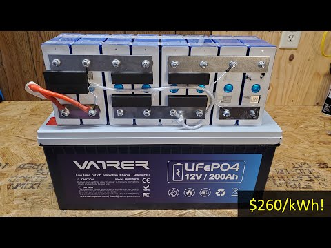

    I debated including a Lithium Ion "fire video"--In the end, I decided to include one. Mainly to show how even small cells failing can easily propagate a fire:
    https://www.youtube.com/watch?v=8nz5ijXcckI
    For solar systems and DIY energy storage, highly recommend Lithium Iron Phosphate (LiFePO4) batteries or possibly newer "safer" lithium cells. This chemistry stores a bit less energy than other Lithium chemistries, but tend not to explode into flames with cell failures.

    Regarding "fire safe bags"... Remember, that Lion Ion batteries also output a tremendous amount of (very hazards) smoke & fumes.
    Even if you manage to keep the "flaming materials" in the fire resistant bag--You are still left with lots of smoke and poisonous fumes... I ran across the number of 1 liter of fumes per 1 WH of Li battery capacity--I cannot find it now, but if I am anywhere near correct that for a 2,400 WH battery, would be something like 2,400 liters of fumes/smoke/etc...
    I get nailed every so often for being so negative about Li Ion batteries and their possible failures. Yes, a well designed system does not fail very often--But they can fail.
    Besides the "normal" stuff that comes out of a fire, one from Li Ion fires is hydrogen fluoride gas, when mixed with water (fighting the fire), makes hydrofluoric acid. If you want to scare yourself, look it up.
    Even well designed and constructed large battery installations have failed (utility size). The failures are not all in "our control". And for a DIY guy getting started--It is a casual stroll in a minefield.

    Here is, what appears to be, a well built Li Ion battery:
    https://www.youtube.com/watch?v=x2Tllo3_Bhw
    Note that the mfg. has improved their design based on customer/YouTube reviews (in this case, they were using soldered lugs and leads, and updated to crimped wire connections--Which is an improvement.
    However, this battery fails the disconnect battery from charging if below ~50F. The BMS chosen by the Mfg. is either poorly implemented, improperly spec'ed (vague temperature function specifications), or "broken" from factory. The BMS may also be using "generic" FET devices (no markings). Sometimes that is a bad sign (grey market components) or the BMS company "erased" the component markings to make "cloning" of the hardware by others more difficult.
    My two cents... Aluminum bus bars (apparently aluminium from video review)--Aluminium is a poor choice until correct alloys, plating, use of anti-corrosion grease per connection, use of starlock washers or similar to "cut through" aluminium surface corrosion. Nylock nuts do not work if the threaded post/stud/bolt threaded portion actually extends a 1.5+ threads beyond the Nylon bushing inside the nut. In this case, there are other locking nuts that may work on the shorter studs--But that becomes problematic because of the thick aluminum(?) bus bars and adding a starlock washer may make the studs "too short" for proper bolt up.
    And my whole warning about fire from Lithium Ion... The battery construction is by the manufacturer. The best you can do is buy from a known good/responsible manufacturer and a "fire resistant" Lithium Chemistry (such as LiFePO4 lithium iron phosphate).
    Using Fiber Tape to hold the cells together--I am not sure is a great idea. Typically (from what little I know) use metal clamps to hold the cells "compressed". Tape and glues tend to degrade over time and temperature.
    Don't even know if the battery case is built from flame resistant plastics--And no UL/NRTL marks. The CE mark is (from what I have seen before) is ambiguous as to what it means (typically not UL, but a mfg's declaration that they comply with European requirements--No third party Listing/Ongoing inspections typically).
    So--Here we are--An apparently responsible Li Ion battery manufacturer that has yet to "master" the "safe/reliable" construction of a "black box" based battery.
    And my "warning"... These are opinions based on a random Youtube video review. I do not know what the bus bars are (copper, aluminium, plated aluminium, or whatever).
    If you bought good quality cells (prismatic in this case), and used copper vs aluminum bus bars, and had a BMS that actually functioned correctly, you can do better.
    A quick example of the issues that even the "experts" can get tripped up--Especially "new companies" and "new to them" products.
    Hopefully somebody here can give you some names and links to quality components they have used.
    -Bill
