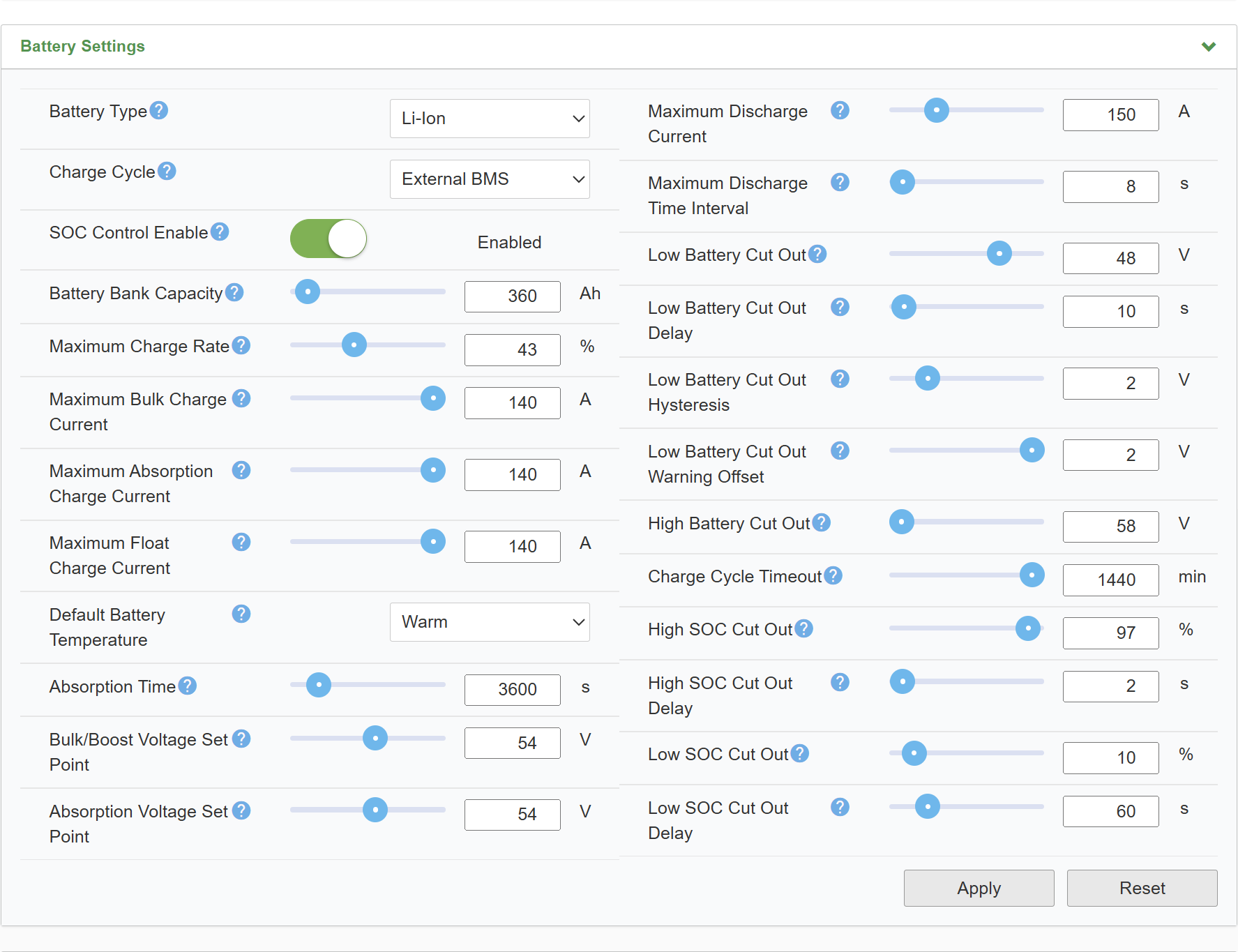

    The best I can do is a screenshot from Insight mobile because I am not home right now. The batteries are at 100% this evening and are not accepting any charge
  • Mtnsun
    Mtnsun Registered Users Posts: 38 ✭✭

    Here is a screenshot From Insight local of the fortress bms

    If you look at my Bms screenshot on insight local a few posts above, you can find the Soh on the right side about half way down.

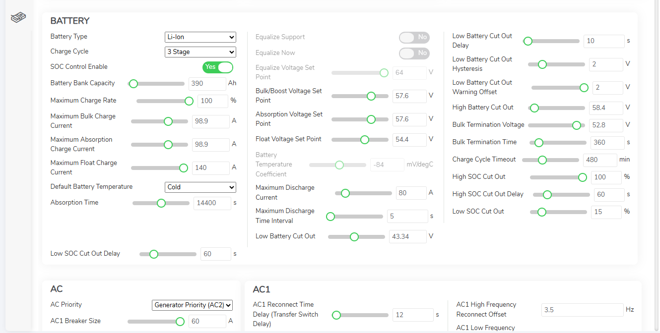

    Dave, I decided to go ahead and try SOC between my XW Pro and Fortress.  It's working quite well, for the most part.  The enhanced grid support works great, too.  No issues charging from solar.
    One issue would be when I need to charge from the grid due to low or no solar.  The inverters will tend to overcharge the batteries using Fortress recommended bulk and absorb settings.  I have reduced bulk and absorb to 54V, and I'll see what happens next time.  With the BMS Setup in Insight Home, I selected the option to have the BMS set the bulk, absorb and float settings in the charge controller, this works well.  I notice, though, that when the inverter overcharges the batteries, the BMS reduces the settings in the charge controller and disables the MPPT charger.  The BMS also shows that it is not permitting a charge.  This appears to clear after a while.

    I ran these batteries for one year in voltage control mode. I've been running with SOC now for almost one month.  I intentionally reduce the charge rate when charging from the grid, pushing only 60 amps to each battery, well below their max of 140 amps - see screenshot.  I initially tried Fortress recommended settings, per their attached document.
    Now I've reduced bulk and absorb voltage to 54, I'll see results next time it has to charge.  Note that the BMS does set/reset some of the battery settings (for instance I have two batteries, 360 ah each.  I enter 720 ah capacity and it will get reset to 360 overnight ... ).  I get different information from Fortress on recommended voltages and SOC viability depending on who I talk with.  They allude to unspecific problems.  Basically, I like running with SOC control better than voltage at this point.

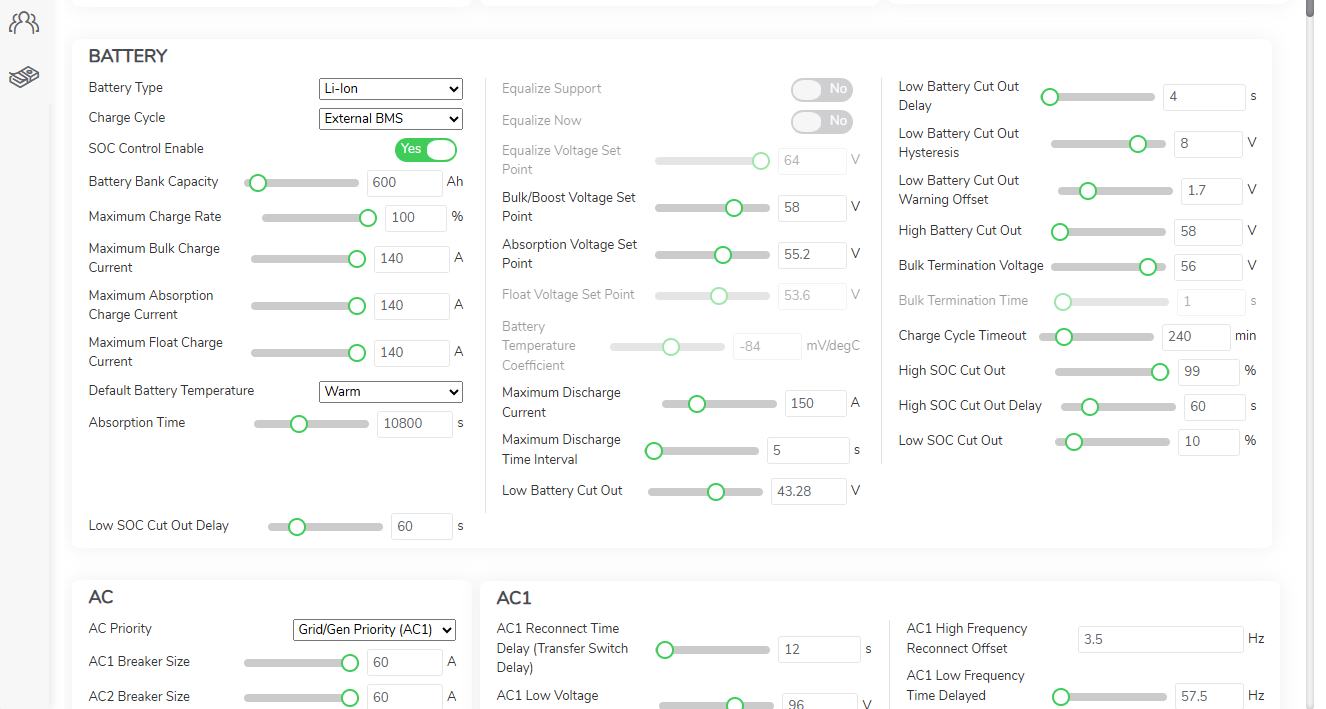

    I really only dabbled with Fortress a couple times. It was alot of work compare to Discover, for me...
    On Discover the BMS will look like below.
