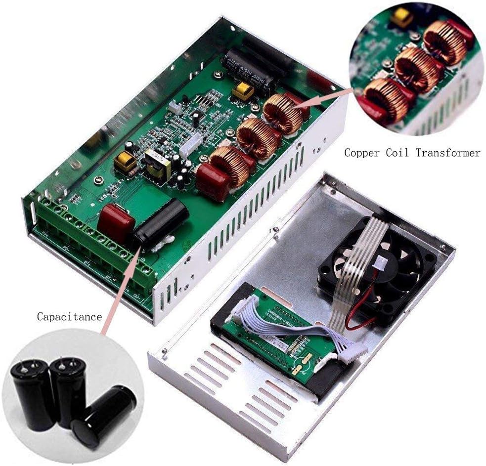

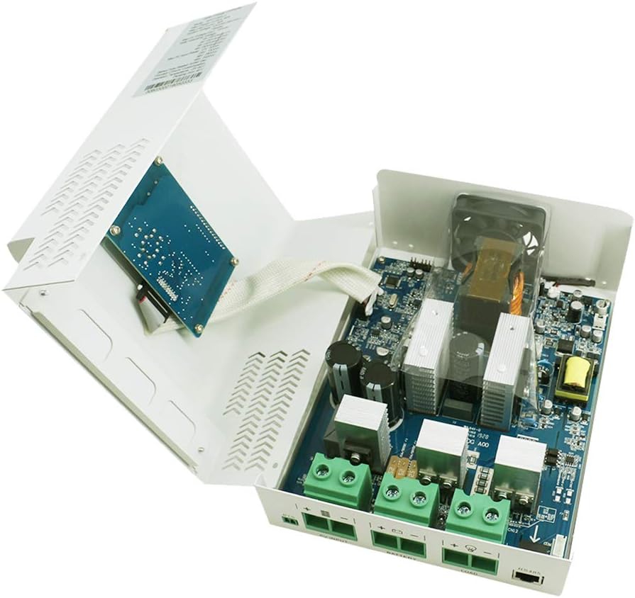

In general, what makes MPPT charge controllers is the relatively large inductor (typically a toroid) inside the charge controller (cost of copper and cost to "wind" the inductor). Some MPPT charge controllers have relatively low input voltages (less than 100 VDC max input), and others are higher (140-150 VDC to 600 VDC). Higher input voltage controllers tend to cost more. And the typical higher end off grid MPPT controllers are around 60-90 amp output (typically 12-48 volt or a bit higher battery bank nominal voltage).
You can find very inexpensive MPPT charge controllers--Some are OK, others are not. And many of the "cheap" variety over the years have shown to be PWM type controllers with "MPPT" simply stamped on the outside of the case.
Generally, the higher cost MPPT charge controllers have more internal programming options, sometimes external outputs (for controller vent fans, optional loads, etc.)... And some have Internet Servers inside to allow partial or full control over the Internet.
The higher cost controllers have a generally good reputation (some folks do have issues). And the under $200 MPPT controllers--There are some out there that seem to be OK... Others not so good.
