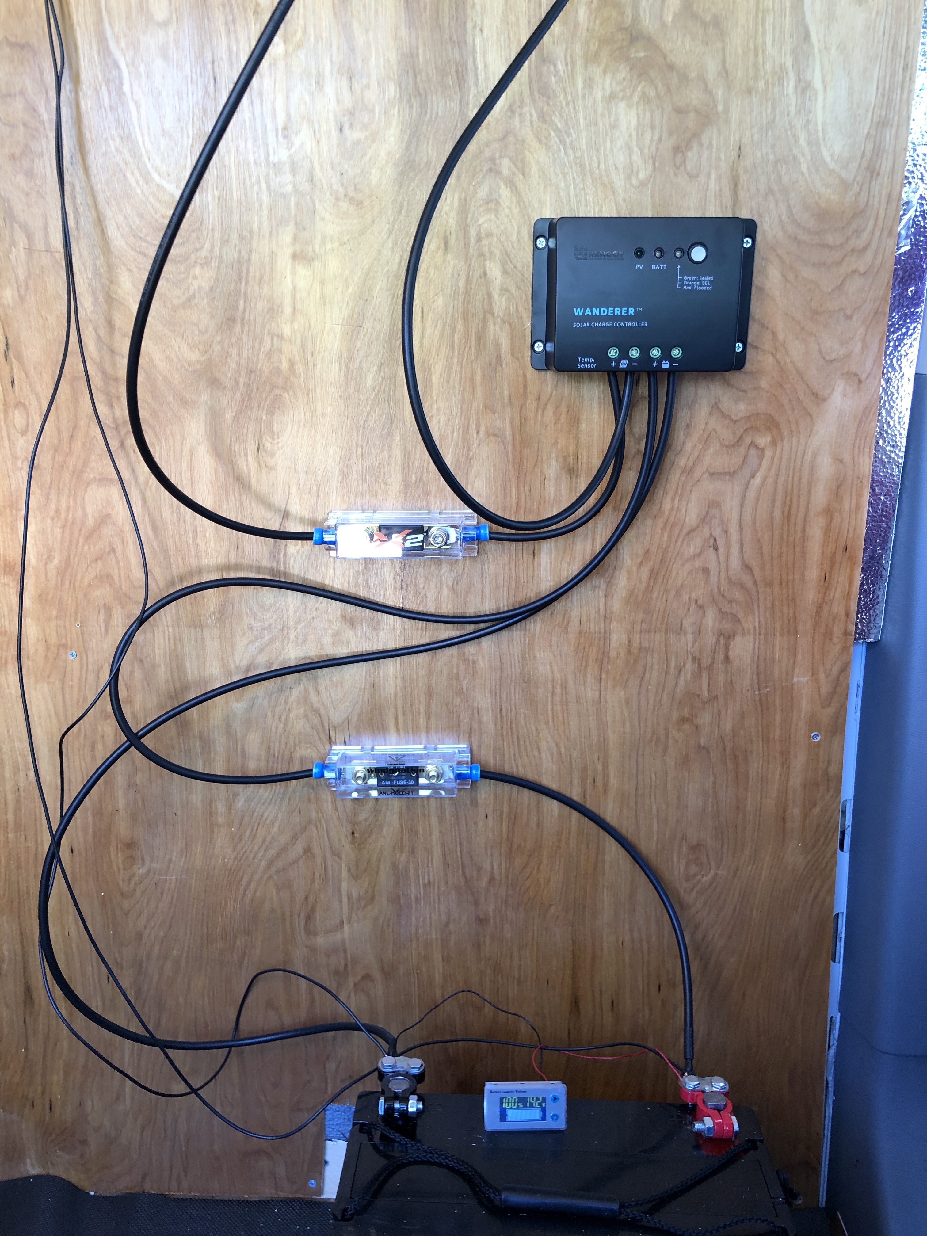

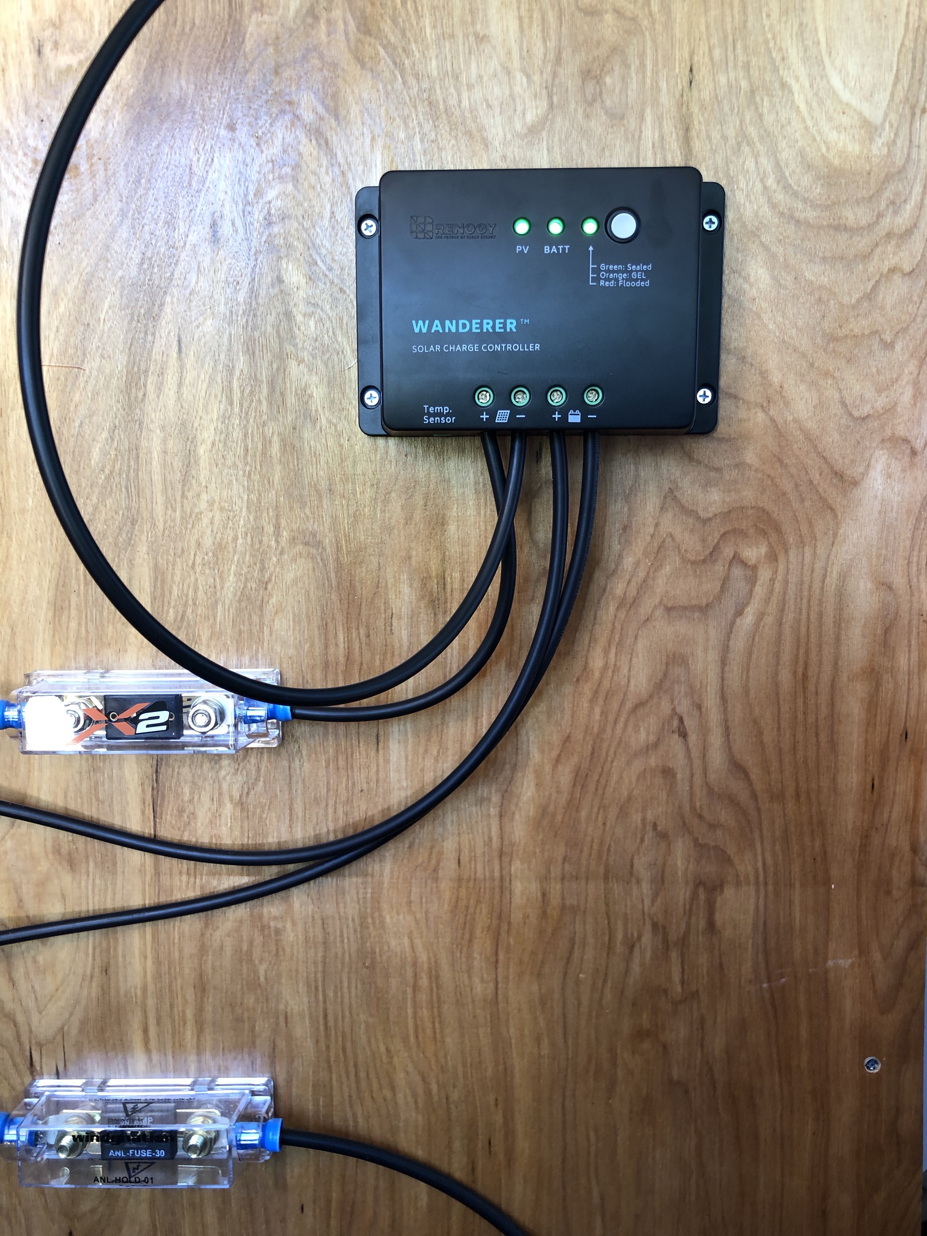

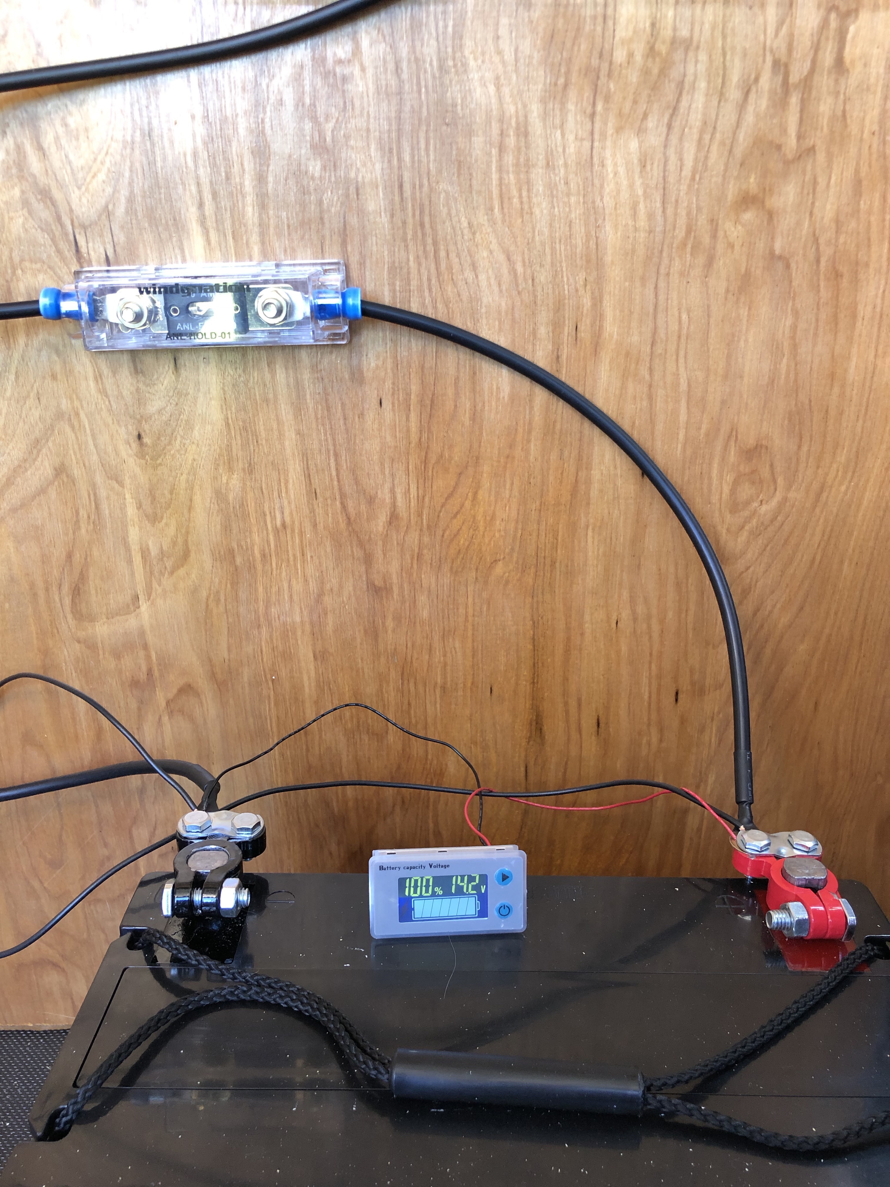

  • ssmith1952
    ssmith1952 Registered Users Posts: 25 ✭✭
    Pictures to come soon
  • Estragon
    What are the thinner (12ga?) wires going to the battery for? I see a pair of thick (8ga?) black wires going to the controller, and a red and a black (16ga?) apparently going to the meter sitting on the battery, but can't see where the two slightly thicker black ones go. Something above and to the left of the controller?

  • ssmith1952
    Those wires are for the exhaust fan

  • BB.
    BB. Super Moderators, Administrators Posts: 33,734 admin
    The setup looks OK... And the 14.2 voltage when charging is correct for a sealed lead acid battery.
    The exhaust fan should have a 2-3 amp fuse (or so, depending on the fan) to protect that wiring against shorts.
    Also, how much power does the fan draw, and how many hours a day do you run it? If you run even a small fan 24x hours per day, it can use most of the energy harvested from your solar panels.
    Can you show a picture of how you are connecting the AC inverter?
    The cables are a bit long... It is better to run them side by side and short/direct runs side by side for the +/- cables (bundle tie together). But, I don't see them as being a cause of the problems you are having.
    If the battery voltage (as measured at the battery terminals) is dropping that quickly (a few seconds with the inverter just "turned on" and no AC loads--It would seem that you have a bad battery.
    -Bill
  • Estragon
    I also don't see any obvious problems with wiring that would account for your problem. As Bill noted, the fan should be fused (the meter too, for that matter), but that wouldn't solve your problem.
    Since the inverter apparently works when connected to another battery, Bill's notion that the battery has lost capacity seems quite possible. Do you know the amp draw on the fan? Does it drain the battery faster than expected without solar?
    Either that, or a bad/shorted connection to the inverter. As mentioned earlier, taking a good, fully charged, 100ah battery down to 10v cut-off in a matter of seconds takes a lot of current. Enough that I'd expect something to get pretty hot in the process.
