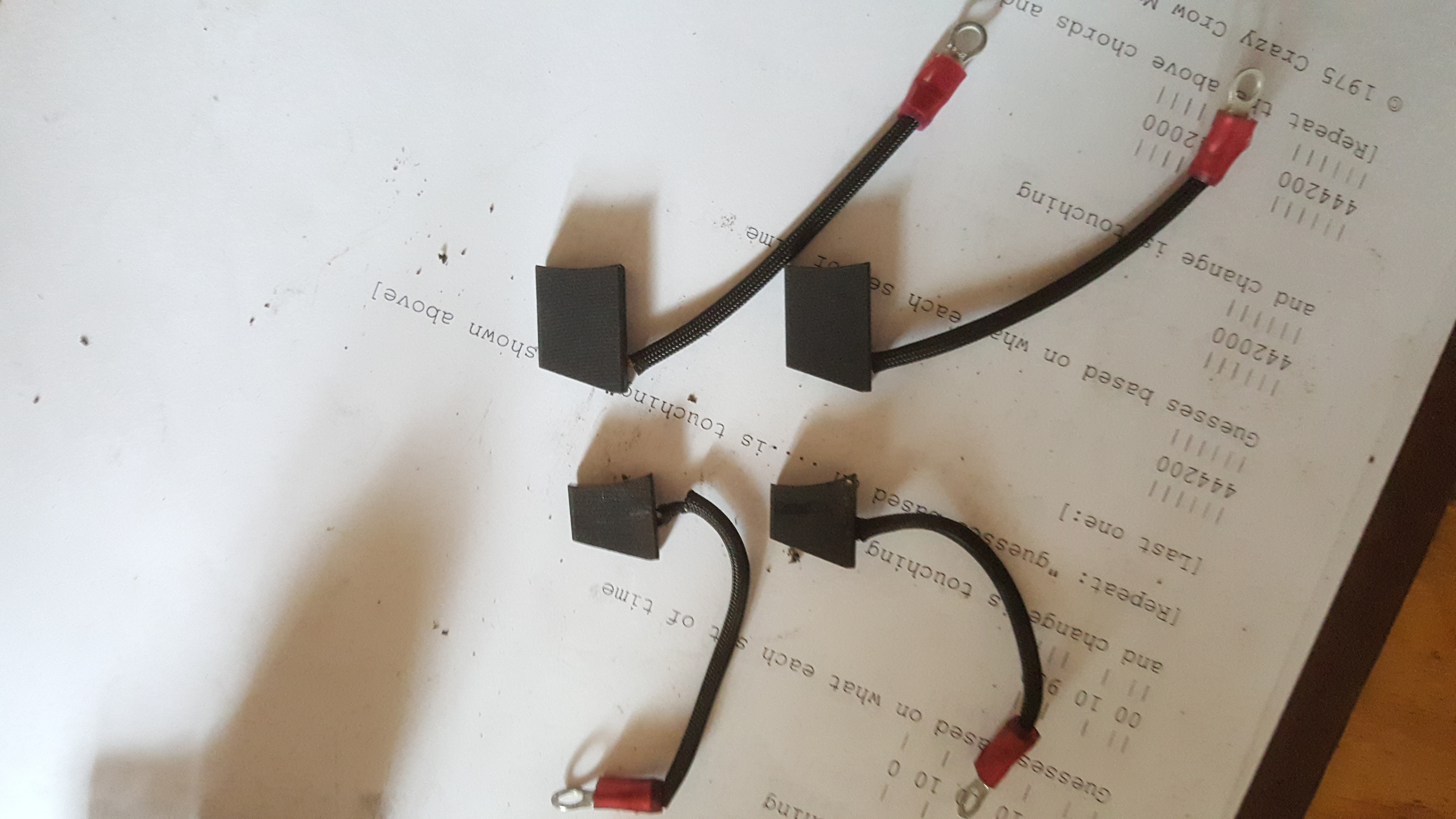

    Good news so far. Brushes were quite worn. One had frayed wire riding next to the slip ring. Gen started right up. Will check voltage tomorrow to see if voltage regulator needs replacing.

    Original problem was occasional shut down, charge controller showed low voltage fault. I checked connections,etc.
    Then a few weeks later, gen would crank up, begin to run for a split second then immediately shut down with an under voltage fault showing on the genset.
    Brushes changed, now all good. No need for change on voltage regulator.
    Not sure I know the answer to your question...I think originally the charge controller shut down the gen for low V. Then the gen began shutting itself down.
    Some say those brushes look older than 850 hrs, I'll just have to change them again in another 700.
