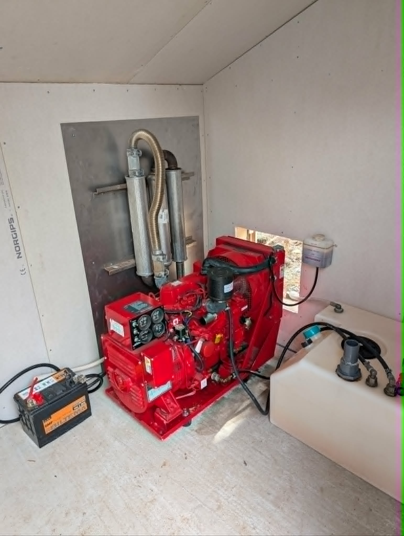

  • _OS_
    _OS_ Solar Expert Posts: 207 ✭✭✭
    Hi everyone!
    My project is coming along very well. Below are a couple of pictures.

    Have moved my batteries to the cellar this summer. In the picture below the battery bank to the right is my main bank. The four Concorde to the left are for "emergency" and can charge the main bank via a DC/DC converter. I control this remotely via an app on my mobile. Also I doubled my PVs (to 800W) and made a mount for them.

    I cannot tell for sure--But the solar array mounting looks like it may need more "fore/aft" bracing???? I am worried that a wind gust could fold the mount "flat" to the ground (I see some wire bracing, but I don't think it is enough).
    Also, you have a small diameter (gauge) red wire from the battery + bus back up to the main panel (power for a battery monitor or something?).
    It may be the photo, but the wire looks to be in very poor shape (burned/failing insulation?). Ideally, the wire should be checked and possibly placed in a secondary tube of some sort to reduce the chances of a short circuit/damage. Nominally, a fuse should be placed between the battery + bus and the wire (near + bus) to protect against downstream shorts.
    Another option would be to move the battery + (and -) connections into your DC wiring box (connect via fuse to the + bus in the DC panel). That would help protect your small diameter wiring from damage/issues with the battery bank exposure.

    Below is a better view of my batteries in the cellar. The batteries to the left are my old + my brothers old (four SunXtender 300Ah in 2s2p configuration). I use them to charge my main batteries in the darkest months. I use the blue box in the lower right to charge them. It is a Victron DC/DC converter that can bulk charge. The relays to the right of it is to reverse the direction of the charging, so I can charge the spare batteries from the main bank when the main bank is fully charged.
    The white cabinet is a Midnite Solar Mini-DC. The gray one to the right of it a 12V DC/DC that I use for a Control By Web relay as well as my mobile broadband router seen in the other picture. Finally, the blue box to the left is another 12V variable out DC/DC that powers a kerosene/diesel heather (pictured) in the main cabin. The kerosene heather can be started remotely with a text message from my phone.
