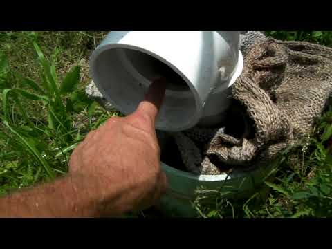

    Yesterday, mid-afternoon, one of the neighbors a few miles away called because the utility power was out due an ice storm and he was trying to pump up his well pressure. He has a twin Onan 3.5 kW generator on a transfer switch that hooks it to his utility panel so he can run his air compressor for his air-powered well. He also has a Outback GVFX3524 inverter with four six volt golf cart batteries on it to keep his lights and 'fridge and freezer going. He doesn't have solar panels or anything. The inverter is hooked up the utility panel and it charges the batteries and keeps them up so his lights don't go out when the power goes out. And by flipping the transfer switch he can charge the batteries up with his generator.
    His old Onan gave up the ghost and wouldn't start. So he called me to ask if he could borrow our Champion generator and Trace transformer so he could pump up his well pressure. Our Champion generator would not start the motor on the air compressor. It killed it dead in its tracks and tripped the breaker. So I got the wild idea of swapping the wires around in the compressor motor for 120V and putting a temporary cord on it to try to run it with the inverter. The inverter wouldn't start it either. It's older than the hills and all the motor would do is hum, then overload the inverter.
    He don't have a Mate for his inverter so we couldn't try using the Gen/Grid Support feature in it, because no way to set it up. But I told him about it, and that it might be able to run his well compressor on 120V using that feature with both the generator and inverter together. So he's going to order a Mate for it and I'm going to help him set it up.
    So question for mtdoc - the old Onan (needs a fuel pump) has a 15 amp two-pole breaker on it. But he'll be able to use only one leg of the generator (maybe 2,000 surge watts) and the inverter will have to supply the rest to start that air compressor when the power is out. What settings do I use in the Mate for that? I am TOTALLY lost trying to figure out the Outback's Mate and never have been able to figure out the menus in it.
    Thanks!
    Chris
  • Ralph Day
    Ralph Day Solar Expert Posts: 1,038 ✭✭✭✭
    Re: Demonstration of Generator Support
    I'm stepping up to the desk, teacher... how the heck does compressed air provide water to a house? Never heard of this before. Always ready to learn.
    Ralph
  • ChrisOlson
    ChrisOlson Banned Posts: 1,807 ✭✭
    Ralph, I'm not exactly sure. He has an air compressor that forces air down the well in one pipe and forces water up in another. I guess it works pretty good but I'm not sure of what's in the well to make it do that.
    Chris

    Just came from my neighbor's place to pick up our Champion generator. He built his air powered well pump and I looked at another one he has laying in his shop. The only moving parts in it are two check valves - one on the bottom of a "collector tube" made of PVC, and another on the top. And it has a air powered relay on the top of the well. The water flows in the bottom check valve, the air powered relay turns on air to the "collector" which closes the bottom check valve and forces the water up the pipe. The air relay turns off the air and exhausts it to relieve the pressure on the "collector", which closes the top check valve, it refills thru the bottom check valve, and just keeps on cycling.
    He said it pumps up his pressure tank to 40 psi no problem as long as he has 40 psi of air pressure. He said his compressor only runs once a day and it will pump water all day for he and his wife's needs, plus some cattle and a couple pigs they got, running off the big air tank on the compressor. The only electricity it requires to run it is what it takes to run the air compressor.
    He said he copied it from the Amish people and they use a gas engine to pump up their air tanks.
    It's so simple you wouldn't even believe it.
    Chris
