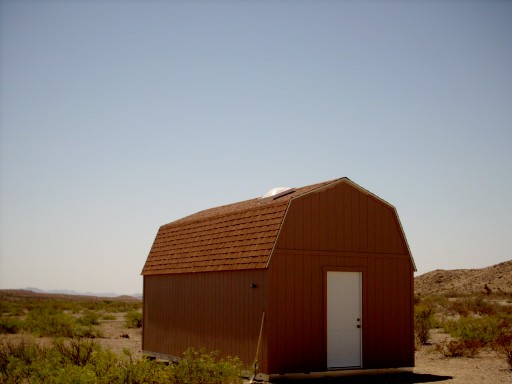

    Its already built.. about 2 weeks back.. 12x24.. no windows yet just 2 skylites for natural light and a roof end vent..
    Its Country Club tanish/grayish..
    Next trip out will be solar and plumbing.. the good news for the PV is no trees.. not so good for me.. LoL

    I'll be getting 3 insulated house size windows when I get out there for permanent.. just trying to prevent breakin/breakage abit..
    The back 10' of the 12' x 24' bottom floor will have a loft up top with a 5'6" height (for 2 beds).. the bottom part of that area will max out at about 6'4".. I may put the window A/C in the smaller back room that will be there.. which will be 10' x 8.5' (bathroom will be on the back left of the building 9' x 42").. a curtain pulled across the 1st rafter before the back room 'opens up' to the front area may be a good idea too.. keep the A/C in that 10' x 8.5' area with 6'4" ceiling..
    My digital camera made the exterior color dark and brownish.. heres another pic.. my solar panel will be on POSTS on the LEFT side rear corner.. My 10 y.o. son is helping with the floor plan.. and we built a small model of it up here in PA..
    Attachment not found.
