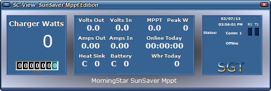

    Looks like our host here doesn't carry the meterbus adapter, so I hope its OK to link to what BB is describing
    http://store.altenergystore.com/Charge-Controllers/Solar-Charge-Controllers/MPPT-Solar-Charge-Controllers/Morningstar-MPPT-Charge-Controllers/Morningstar-Sunsaver-MPPT-PC-MeterBus-Adapter/p6749/
    And with this adapter you can run Morningstar's MS-View or freeware like my SC-View
    http://www.solar-guppy.com/forum/sc-view-morningstar-sunsaver-mppt-pc-monintoring-software-t634.html
