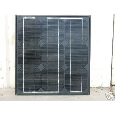

Original System [May 2008]
Designed by someone who figured that trickle chargers were 5W, so 40W should be plenty.
-> 40W total [~2.2 Amps]. One [1] 20W panel* & two [2] 10W panels, all mono-crystalline Suntech cells.
-> Sunforce 60012 7 Amp Charge Controller [14AWG]
-> 2-year old 85AH deep cycle battery. [hybrid, abused in boat & this house]
-> Xantrex 700W inverter** [10AWG]

Setup received another 20W panel for 60W total, and we've taken out the old 85 A/Hr battery for new dual 12V deep cycle. Hope was to be able to make coffee & maybe do some 27" TV / PS2 on the inverter, while maintaining good 12V lighting. The out of commission 26W lamp is waiting on new transformer & the 15W lamp is waiting on new bulb. 700W inverter was insufficient for coffee maker...it beeped in agony & turned itself off. Solar coffee will have to wait.
Recently learned calculations reveal 60W is inadequate for 250A/Hr battery support. Need more & bigger panels. I also learned that much improvement was to be found in converting from standard shunt controller to MPPT. Morning coffee maker without the generator must happen as well as occasional TV/PS2 for movies when surf is flat & chica bars become boring.
Convincing the Mrs to spend more on a surf shack 3 hours away from home is the most difficult thing now, LOL.
System Update [June 2008]
Designed by someone who now realizes there is a long way to go.
-> 60W total [~3.34 Amps]. Two [2] 20W panel & two [2] 10W panels, all mono-crystalline Suntech cells. [16AWG]
-> Two [2] new 12V Interstate SRM29 Marine/RV* [Tied together with fancy 1/0AWG]
-> Sunforce 60012 7 Amp Charge Controller** [14AWG connected diagonally]
-> Xantrex 700W inverter [4AWG]

Wow, you have a wonderful "shack" I used google earth, and located it, and will fly down and drink your beer weekdays !! Just kidding, that's a ploy to have you spend more time there on the beach with the 50cal on the surfboard, to guard the "shack"
Seriously - you've done a lot of work, and I hate to say some needs un-doing, but I'll say it anyway. I wish you had found this board some time ago - and gotten advice then.
Many folks are not partial to the Blue Sky controllers, so if you grow past it, check here for other ideas.
You need a serious large panel, using a MPPT controller with 12V panels will not give much boost effect in a warm climate. On hot afternoons, you may not charge at all, as panels heat up, they loose voltage. Playing the game of adding another 20W panel, another 50W panel will leave you with mis-matched voltages (one might be 18.5V, one may be 19.5V and one 17V) and no MPPT controller will be able to make sense of what voltage it should be trying to work at.
Bite the bullet and get something in the 200W 26V ballpark. Stow it inside while gone, and leave the 50W toy panels out to keep the batteries topped off.
You need to keep the batteries CHARGED. When you run the generator, you need to also hook a charger to the batteries to boost them up, Make the AM coffee, run the gennie for 30 minutes, and boost the batteries. Let the solar top them off. The longer the batteries are lower than 95% charge, the faster they die. Read the battery FAQ
http://www.windsun.com/Batteries/Battery_FAQ.htm
Wire the batteries up "diagonally"
http://forum.solar-electric.com/showpost.php?p=12013&postcount=2
http://www.solarseller.com/battery_bank_wiring_diagram.htm
Here's a great writeup on how/WHY to properly wire your battery bank (diagonally)
http://www.smartgauge.co.uk/batt_con.html
Cheap 40A charger - look at Pep Boys for the ~$110 Vector/BlackDecker 4/20/40A charger 1093D. Has selection for deep cycle, and it's a switchmode type of supply, so I think it's new enough to have a good power factor. (700W @ 40A setting)
http://www.amazon.com/review/product/B00009RB0T?showViewpoints=1
Also has equalize and desulphate settings too, truly shuts down with "FULL" reading on display, and fan idles back when done, so it won't boil cells dry.
No battery temperature adjustment or sensor, but it's a ~$110 unit, and will pump 40A safely into a pair of batteries. You are only running it for 1/2 hr in the AM, when the batteries need it the most. Let the solar top it off, and manage the float and EQ cycles.
Connect it diagonally too - on the opposite pair of terminals from your hardwired connections.

The small panels I started with all share the same construction & were measured at 21.2 to 21.4 V open circuit voltage in direct June sun @ N33° 42' 3" W117°. If a difference between panels of 0.2V is mismatching, then I guess they are mismatched. I thought they were all pretty close, although I didn't plan it that way.>
I'm returning the 50W panel I have on hand. Thanks for helping me to see that it takes too long to scrub an elephant with a toothbrush.
The current 60W set up will be left as is & relegated to a separate single battery dedicated to the 12V lights & iPod only; which has already been proven reliable. It ran fine on the old 85 A/Hr battery, which is back in the boat now. A new sub-100 A/Hr battery will be put in place of the dual batteries until a system is set up for them.
