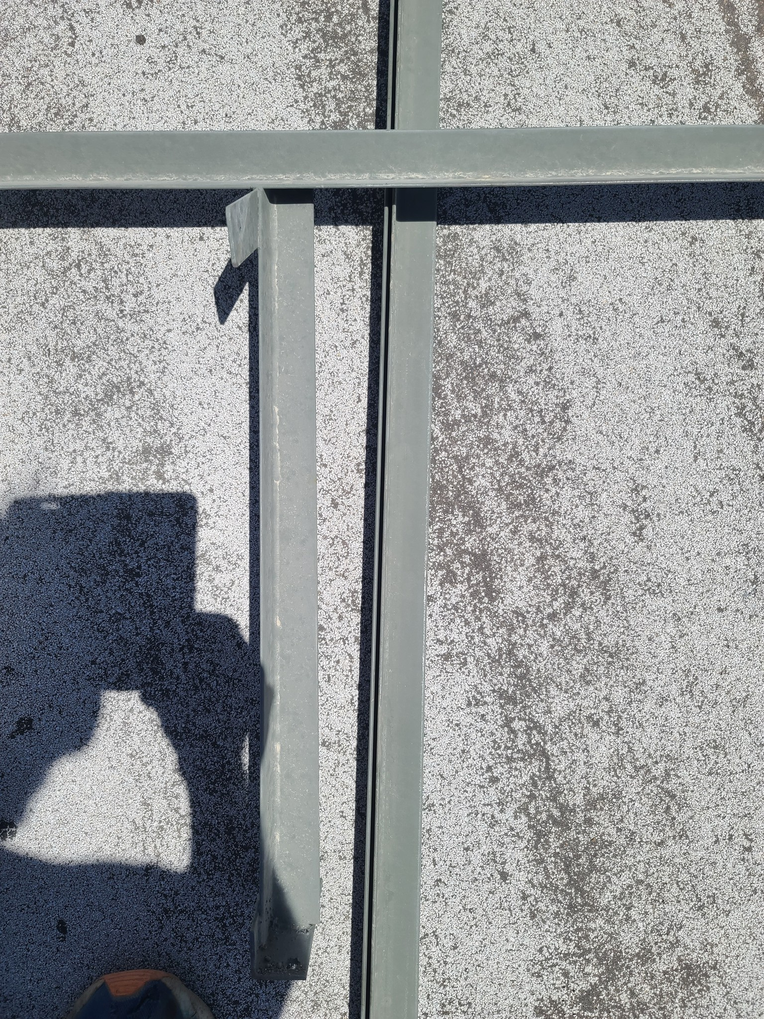

    750 watts are up though not hooked up.  At 67, this all seems a lot like work. Wind makes roof work a challenge.

    Since the angle is only 10 degrees I am wondering if all six panels could go through a single charge controller.
    At high noon this would be ~ 112 Volts and possibly between 30 and 40 amps.
    Would the west panels defeat the east panels early in the morning?
    Would the east panels defeat the west panels late in the afternoon?
