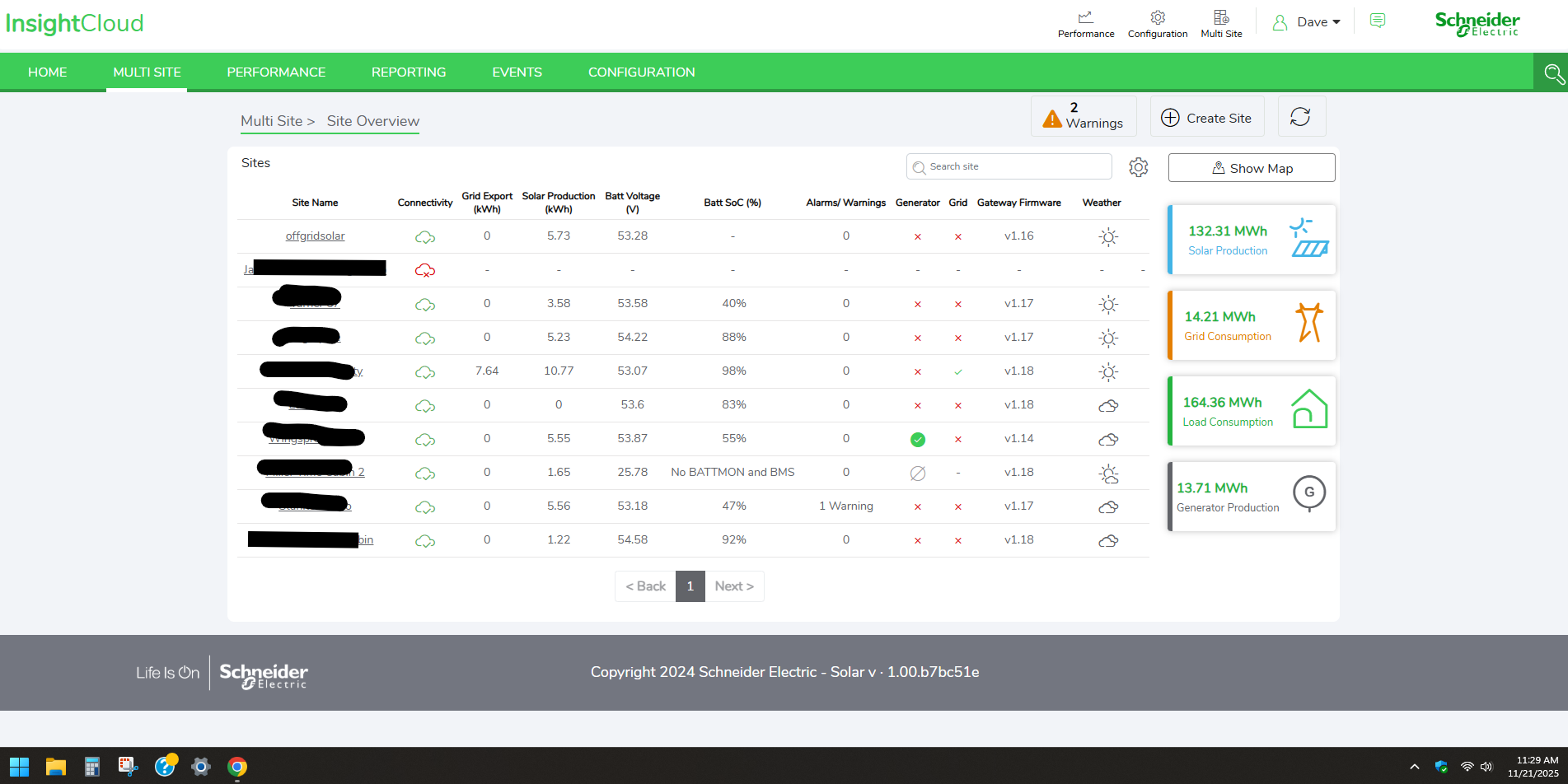

Call the store here ! They still sell XWP. Have them walk you thru it. I still bill this for people but they will do it for free! Below is the Insight Cloud that will modernize your system.
htps://offgridsolar1.com/
E-mail offgridsolar@sti.net -
The only equivalent product that NAZ has for the XW Pro is the Conext XW and the fellow I chatted with did not seem real familiar and suggested it was not compatible. BTW the graphic above doesn't seem to have relevance here??Dave Angelini said:Call the store here ! They still sell XWP. Have them walk you thru it. I still bill this for people but they will do it for free! Below is the Insight Cloud that will modernize your system. -

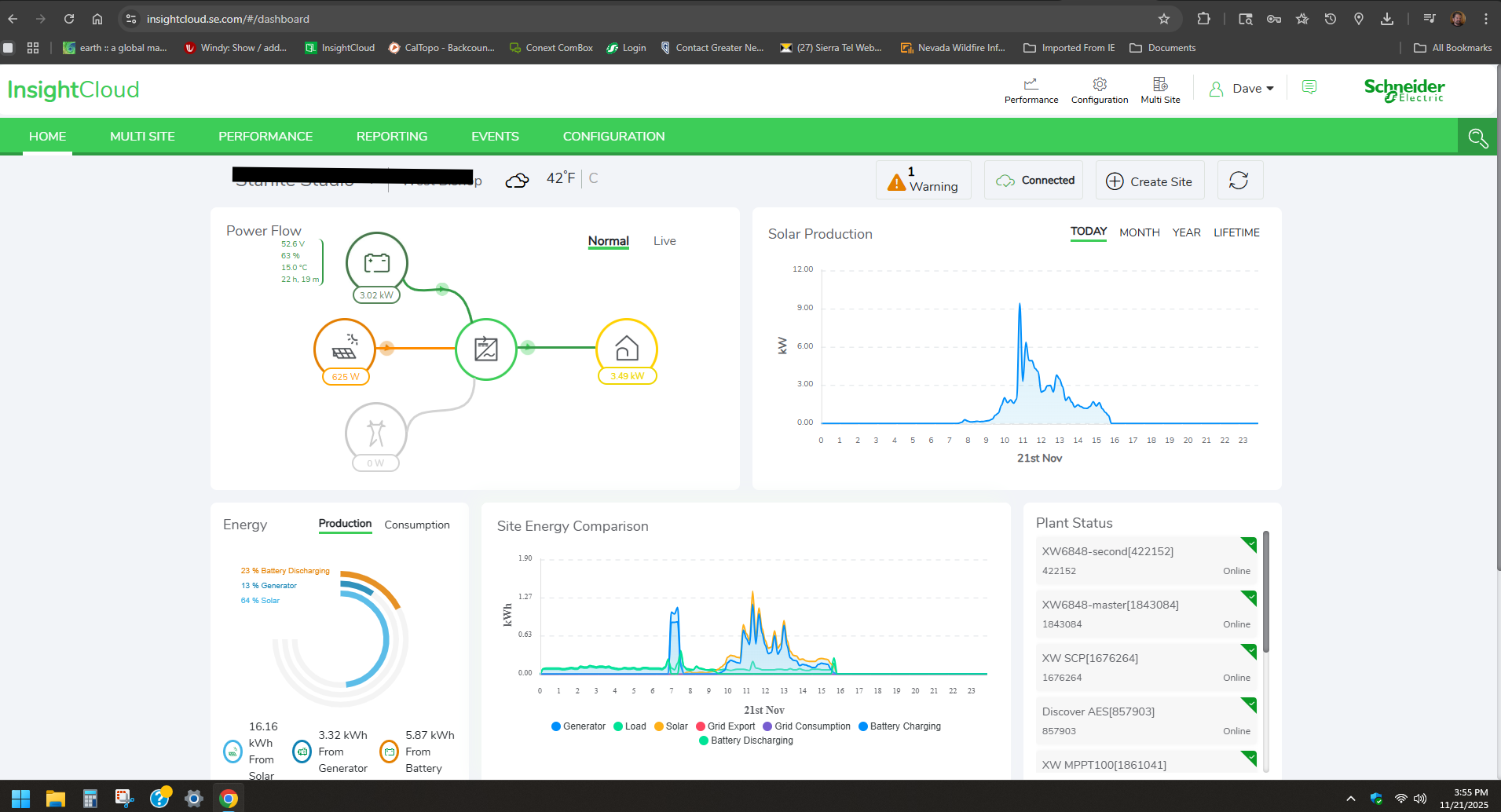

You spoke with the wrong guy! Ask for someone who knows XW! The graph is what you use to see the system. Kind of like the scp BUT a visual method of seeing what is happening. Conext is how XW is marketed for the last 10 years or so.
Your XW gray box is completely compatible with the white box XW pro. The one you have was made from 2006 or so to 2012.
below is a home screen for Insight and a link to Schneider Good luck!
https://www.se.com/us/en/product-range/66297-xw-pro/#overview
